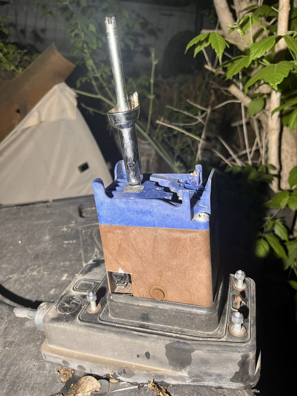

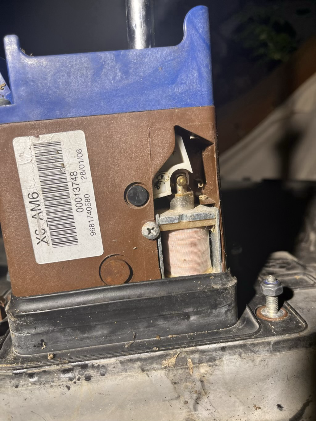

This is where the relay sits. When it triggers, it makes a noticeable click and pulls the white plastic lock downwards (this is what you are pressing to manually unlock).
Are you able to move the gear shift out of P when using Lexia to unlock?
If not, it sounds like either the relay or some electrical issue.

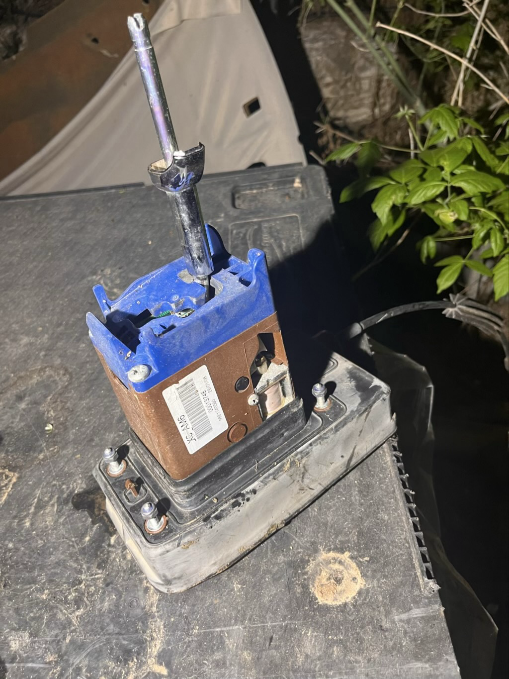

Thanks for the answer Arnonf. You explanation was helpful. I can hear the clicking so I have ordered a used unit. How much disassembly is required here to remove the unit? Do I need to get under the car (and remove the exhaust system) or is it accessible after removing the console plastics covering around?
