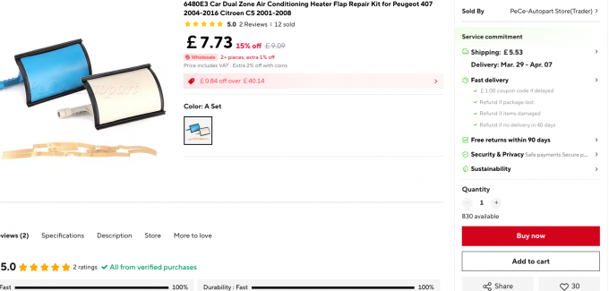

This is an update to let others know that C5/407 mixer flaps also fit the C6, and are still available from AliExpress for a very low price of £13.26 delivered to the UK (Currently 830 units available).
Here is the Link -
