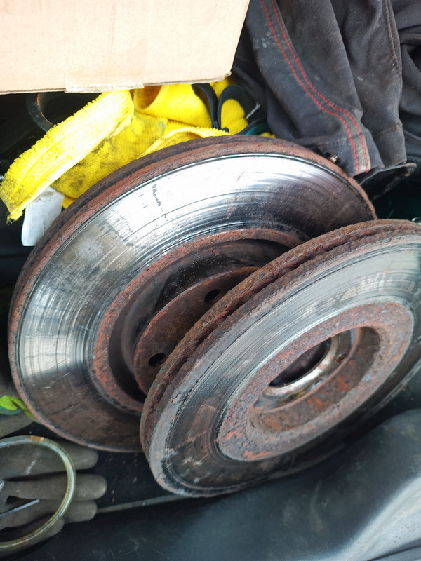

I recently did a rear brake overhaul:
From this:
To this:

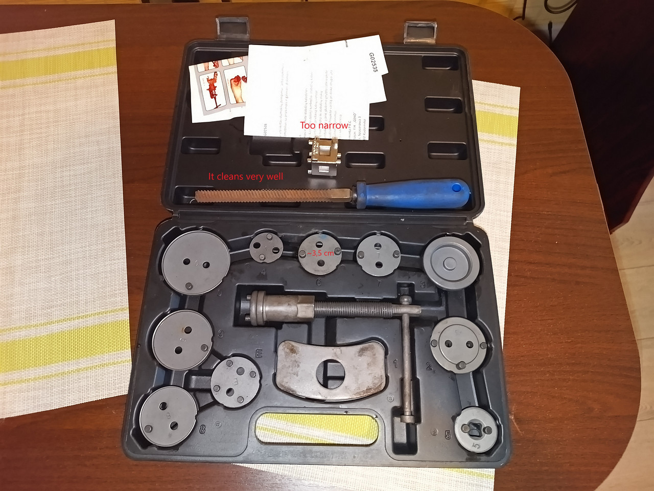

In the middle of the job, I realized that my universal piston tool was too narrow — it needs about 3.5 cm spacing:
Needle-nose pliers helped me screw it in.
I finished the left side first, but didn’t have time to do the right side (not my garage, couldn’t stay overnight). I did calibration and drove away. The next day, I bought a proper brake tool set and finished the right side.

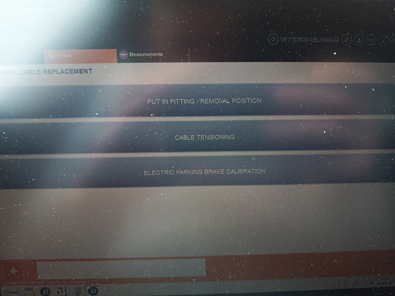

This time, calibration didn’t go well. An orange triangle appeared on the dashboard, and a message on Diagbox saying something like “operation cannot be completed.”

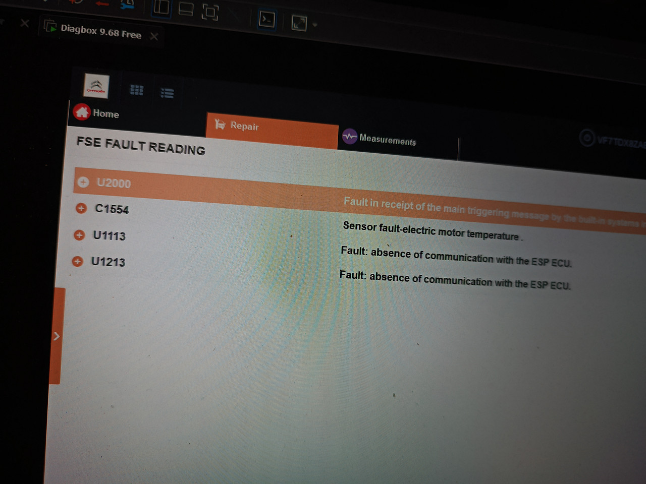

These were the fault codes on the last day:
C1554 appeared first. U1113, U1213, and C2000 showed up later while I was trying to fix the issue. No fault codes in the ESP module.
Diagbox couldn’t complete calibration or tension checks. After several attempts, it finally completed calibration, but the error remained — this time with a red blinking triangle.
The parking brake could lock, but wouldn’t release. After some time, it released by itself. Later, it could lock or release, but still showed a malfunction error.
It seemed like Diagbox couldn’t detect whether the cables were properly tensioned or not. Sometimes the cables could be tightened or released. It didn’t seem like a mechanical issue — no unusual noises, no signs of cable damage or misalignment before using the electronic brake.
I found a similar issue online (Diagbox unable to complete calibration) and tried the same procedure: using the emergency release. It wasn’t as scary as I expected — just a solid “clonk” sound.
After that, I recalibrated, turned off ignition, and the orange triangle disappeared. Now the parking brake works normally — it holds, releases properly, and even holds on a downhill slope.

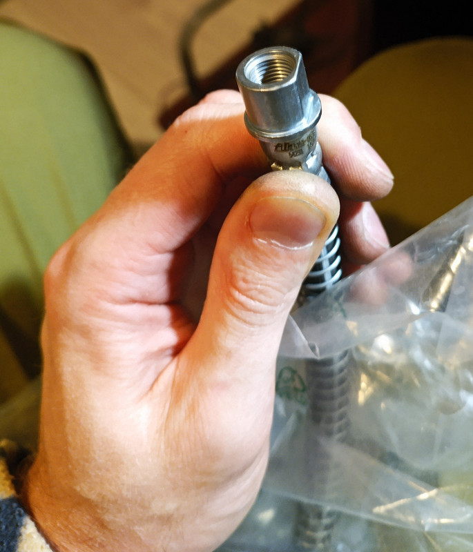

Going to enjoy the car a bit before the next repairs, because I’ve already bought new hoses for the rear callipers… and honestly, I’m already annoyed just looking at their shape:
There is no information in ServiceBox about replacing the rear brake hoses.
