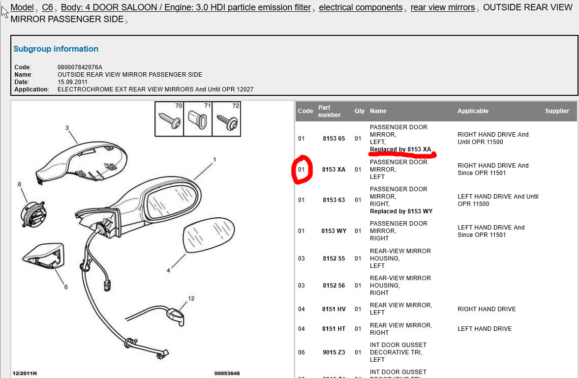

Hi, I have recently purchased a C6 and it is a 2009 3.0D. My passenger (left) wing mirror has a damaged folding mechanism and broken glass. Are the type 2 mirrors unique to the 3.0D or do they change at a certain age? I want to make sure I purchase the correct replacement. Thank you in advance |
![]() ![]() ![]() ![]() Member No: #1
Location: Northumberland |
Ignore the shape in the diagram, Citroën didn't bother changing it in the parts list...![]() |
![]() ![]() ![]() Member No: #320
Location: Bedfordshire, UK |
Kitsamus wrote ... Hi, I have recently purchased a C6 and it is a 2009 3.0D. My passenger (left) wing mirror has a damaged folding mechanism and broken glass. Are the type 2 mirrors unique to the 3.0D or do they change at a certain age? I want to make sure I purchase the correct replacement. Thank you in advance Type 2 mirrors are from RP number 12028 (car build date 14th October 2009). Early build 3.0HDi were fitted with type 1 mirrors. However, mirrors are interchangeable, fixing points & electrical connectors are the same. I once tried type 2 mirrors on an early car and they worked correctly. The RP number of your car is found on the tyre pressure sticker, in the front door shut. Link the the parts website I used, ‘catcar.info’ - Click Here - |
C6Dave wrote ... Ignore the shape in the diagram, Citroën didn't bother changing it in the parts list... ![]() Dave, if you look at the top of your parts diagram, it’s applicable to cars with RP number until 12027, (13th October 2009). I.e. it’s the early mirrors. There’s another parts diagram for cars with RP 12028 onwards. This is when the later large mirrors replaced the earlier smaller mirrors. |
Hattershaun wrote ... Dave, if you look at the top of your parts diagram, it’s applicable to cars with RP number until 12027, (13th October 2009). I.e. it’s the early mirrors. There’s another parts diagram for cars with RP 12028 onwards. This is when the later large mirrors replaced the earlier smaller mirrors. Thanks for clarifying, Shaun. I didn't know very early 3.0HDi's had the smaller mirrors. |
