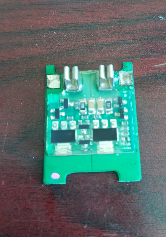

When I opened mine there appeared to be 2 fixings close to where the wiring enters the top surface of the case which I replaced with small self tappers on reassembly. (That's if my memory is correct.) The lid then could be lifted and rotated about the wiring aperture to reveal the motor.
I did adjust the position of the contacts on the motor so as to contact an unworn part of the pads on the small circuit board.

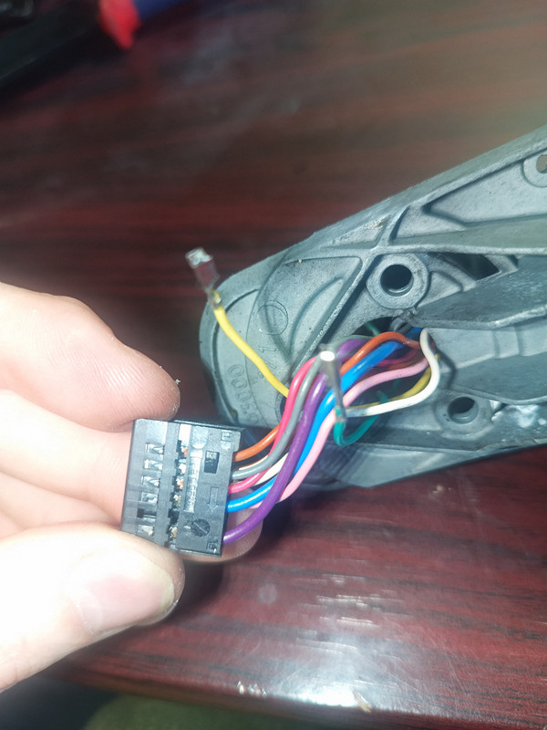

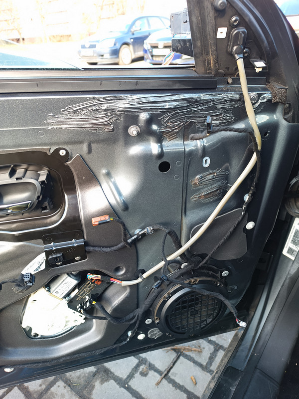

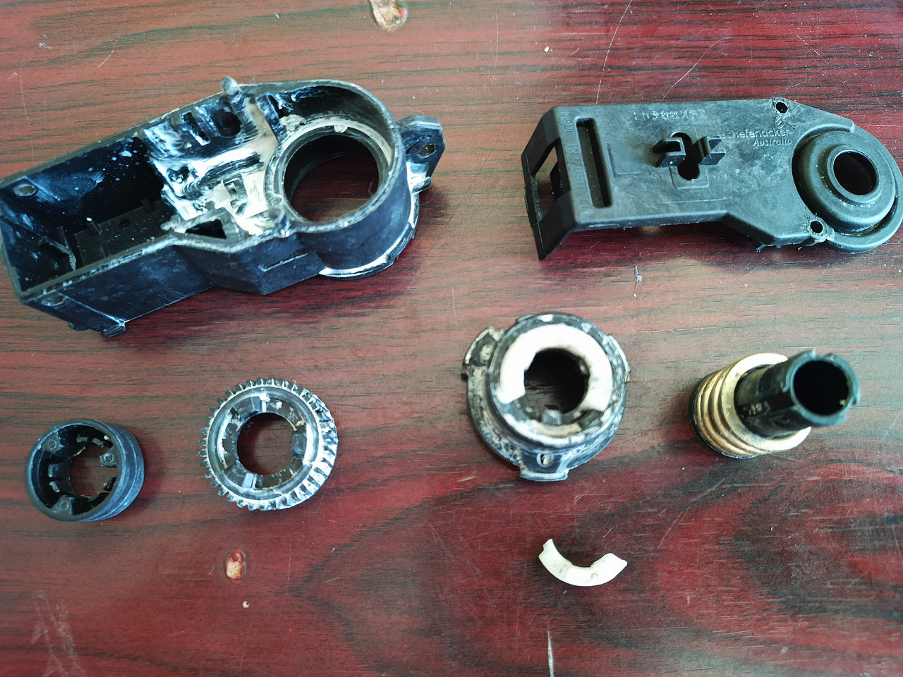

This is the right-side mirror. The issue is that it doesn’t retract back. The problem is a broken white internal gear, which is only visible after removing the top clip.
I bought a generic replacement unit: - Click Here -
After unpinning the wires, the motor can be slid out:
The power connection matches this type of wiring:
I wouldn’t recommend trying to replace only the white gear, as the spring is quite strong. The replacement unit has more durable internal gears, with one of them made of metal.
