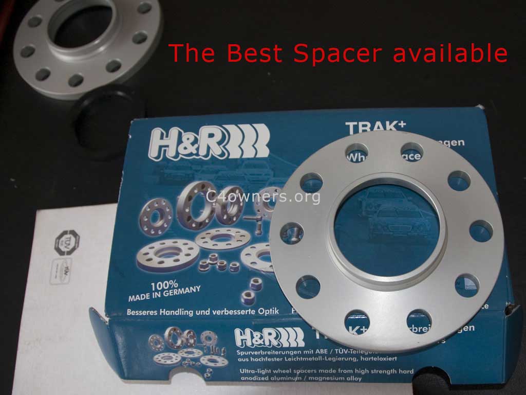

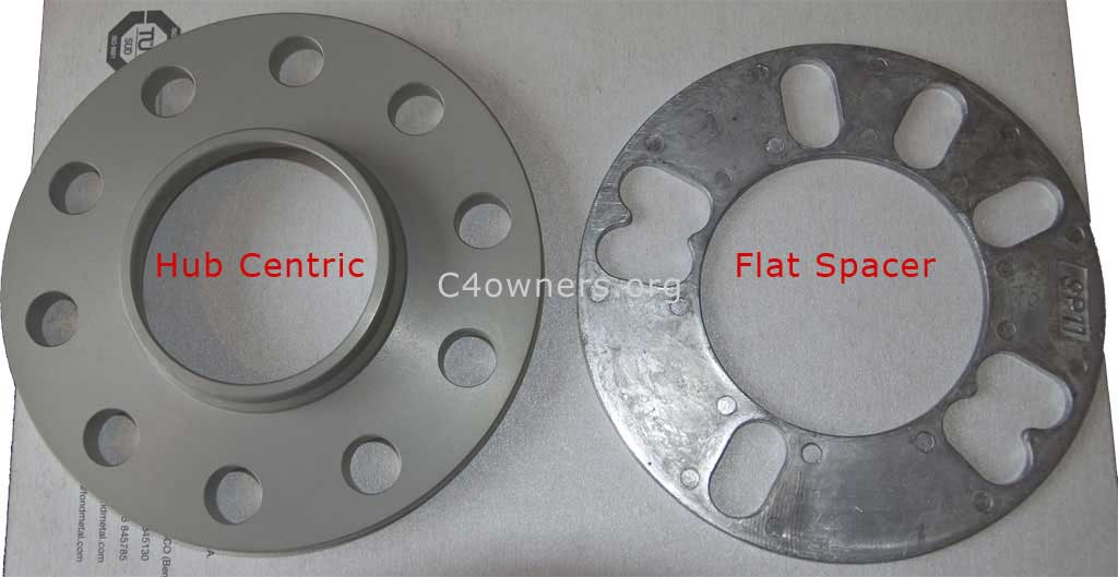

Therefore if you want to fit say ford fitment wheels with an offset of 35-45mm you may require spacers to bring the offset down to within 32/33 mm. You also need to ensure that any spacers are 'concentric' and reduce the 'bore' to the correct size (read on for more info)

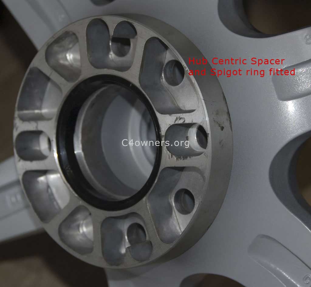

1. The first thing to check is the internal diameter of the wheels - if they are over 65.1mm do they have a 'concentric reduction spigot' installed? (normally plastic) plus if the offset has changed and is adjusted using 'spacers' then are they using 'flat' or 'concentric' ones?
A flat spacer over 5mm should be avoided BTW as there will be little for the hub left for the wheel to sit on.
If over 65.1mm and NO you need one as the wheel is being held in place solely by the bolts so are not guaranteed to be holding the wheel 'true' to the hub circumference so will 'wobble at 65mph+ and which is dangerous as they are taking all the weight of the wheel and not the actual hub on the car. The bolts are not designed to take all the load and with excessive vibration, could shear.

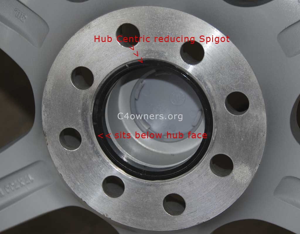

2. They have a 'reducing spigot fitted. Is it the correct size? If yes is it sitting BELOW the internal hub face of the alloy?
If the wrong diameter you have the same issue as 1 - if the correct diameter but sitting 'proud' of the hub face then the wheels will not be sitting 'square' on the but so are not running true, so will again vibrate at 65mph+
