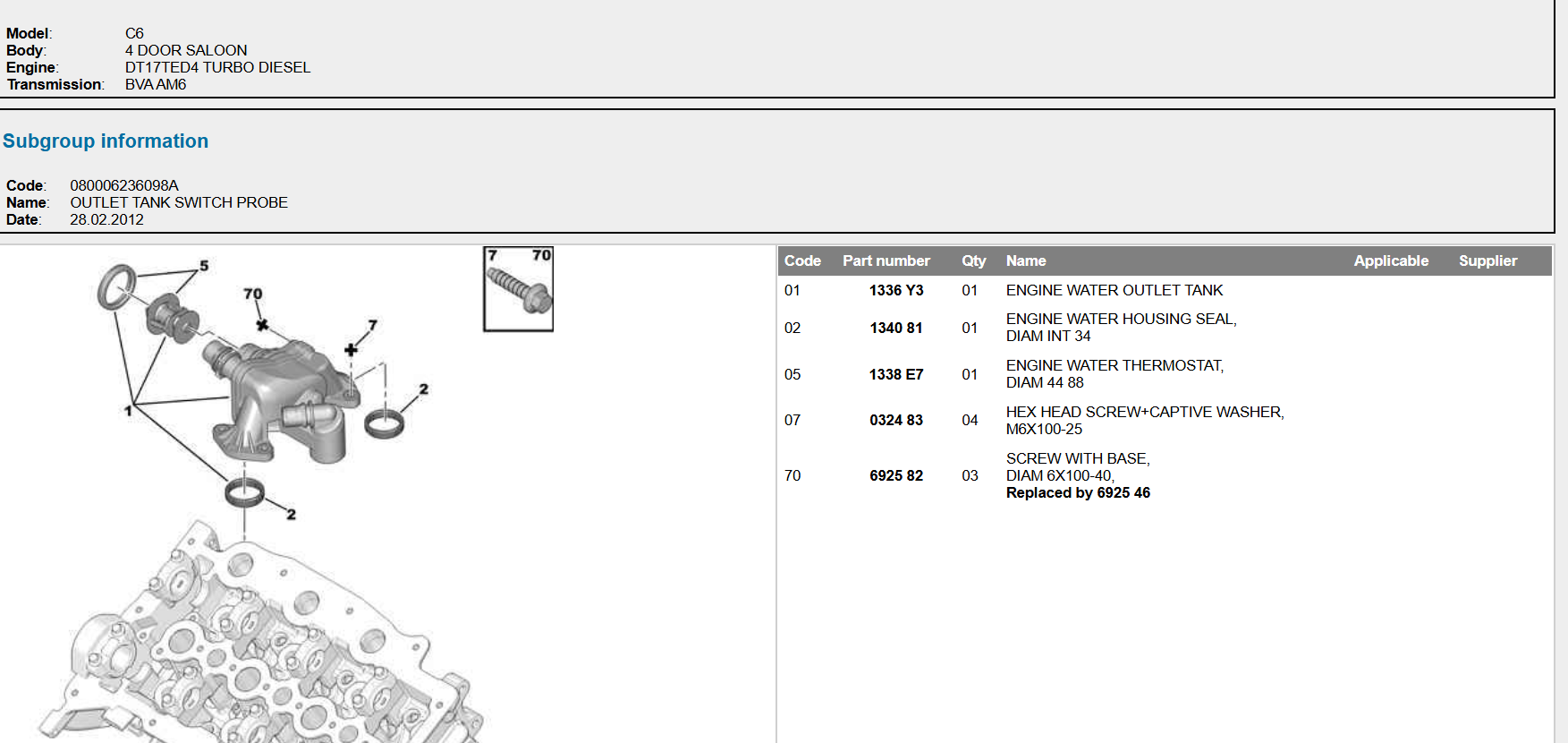

1336Z4; 9657182080 is the part number for thermostat housing that I found on Ebay .
Part is not OEM , but made by TOPRAN .
COOLANT THERMOSTAT
Opening Temperature [°C] 83 °C
Supplementary Article/Supplementary Info with seal
Supplementary Article/Info 2 with sensor
Apparently this includes 83 degree thermostat and a sensor.
What does this sensor do?

For 2.7 HDI is other 1336 Y3

I found this one on Amazon:
THERMOSTAT HOUSING 1338E7 Fits Citroen C6 2008-2015 Jaguar XF 1336.Y3
Brand: Aotop
$45.00
Does the thermostat go inside the water hose ? How is it secured in place?

A follow up, regarding correct THERMOSTAT temperature:
It appears that the thermostat is secured inside the
THERMOSTAT HOUSING / OUTPUT TANK BY 3 SCREWS .
This part is available from many sources : how would I determine which one is the best quality ? ($15 from Ali Express; $45 from Amazon)
