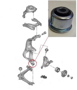

Hi there. Can you tell me where the LOWER bush in the Pivot arm that the bottom triangle arm fits in it comes from please??
This one in my picture.. The one at the bottom. The actual ball joints are in good order.
I have an mot next week and cant find this bush anywhere. Thanks

xmv624v - I'm not sure if this is the exact same one I bought, but it looks identical (eBay link):
There are some pictures of my installation on this thread:
It's a well reported job on this forum though! Should be plenty of help available.
