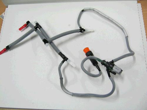

Thu Jul 05 2018, 07:56pm
Joined: Sep 06 2017
Member No: #3261
Location: Byroslavia, FIN
Question: what is this? Its leaking fuel. Part no? Its under/behind the intake Y, above the thermo housing.
EDIT: Its part no. 1574E8. It seems I need to change the whole piping :/
