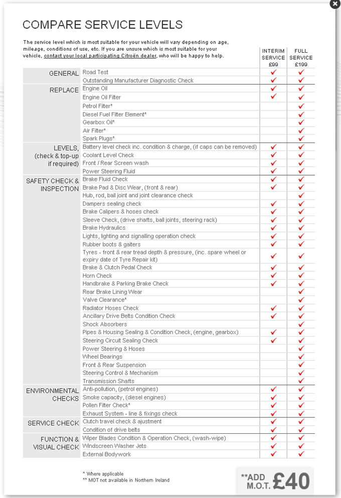

BTW the Citron offer of having an axle set of brake pads replacing for £95.00 (including parts and labour) is still available - Click Here -
A full service is also available until December 2011 for cars over 4 years old for £199http://info.citroen.co.uk/servicing-offer

Thanks Dave, the service deal is good as my 60k service is due in 1500 miles time so will certainly go for that!
