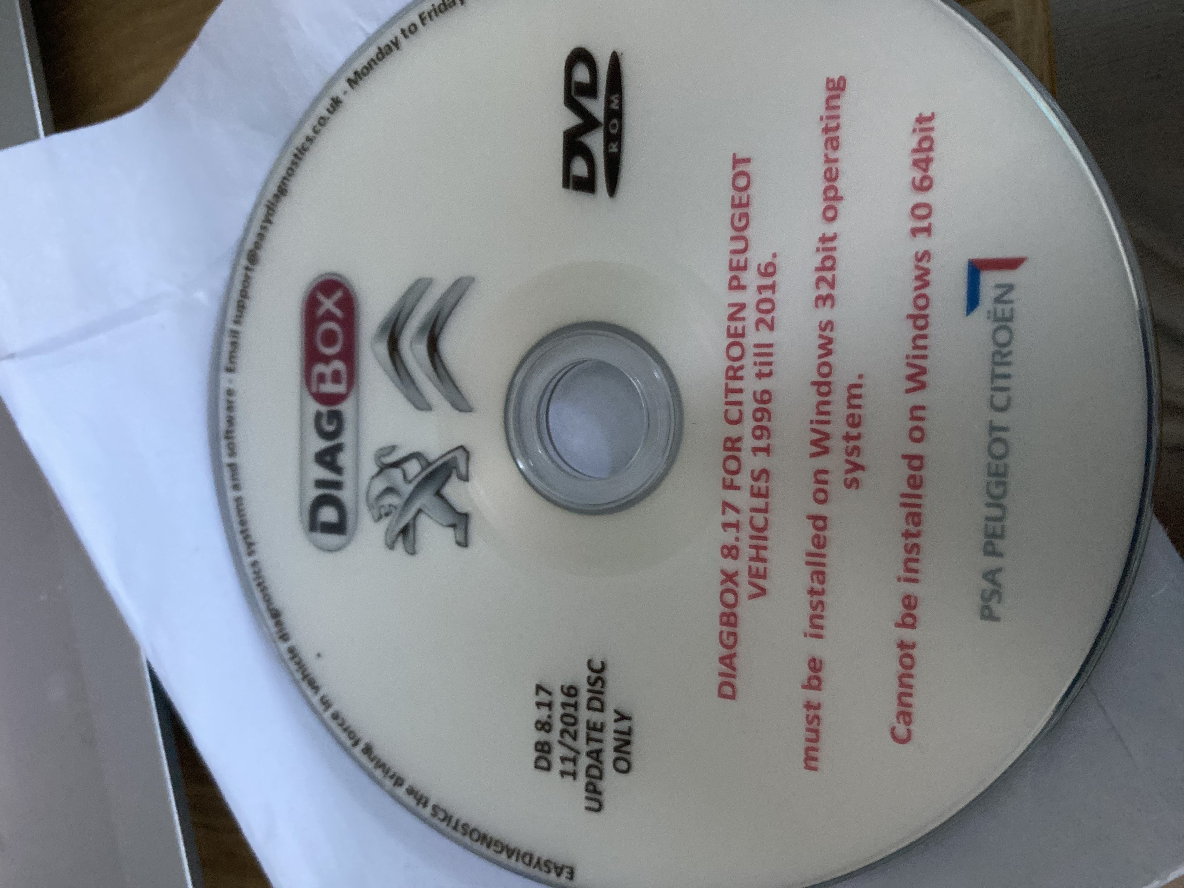

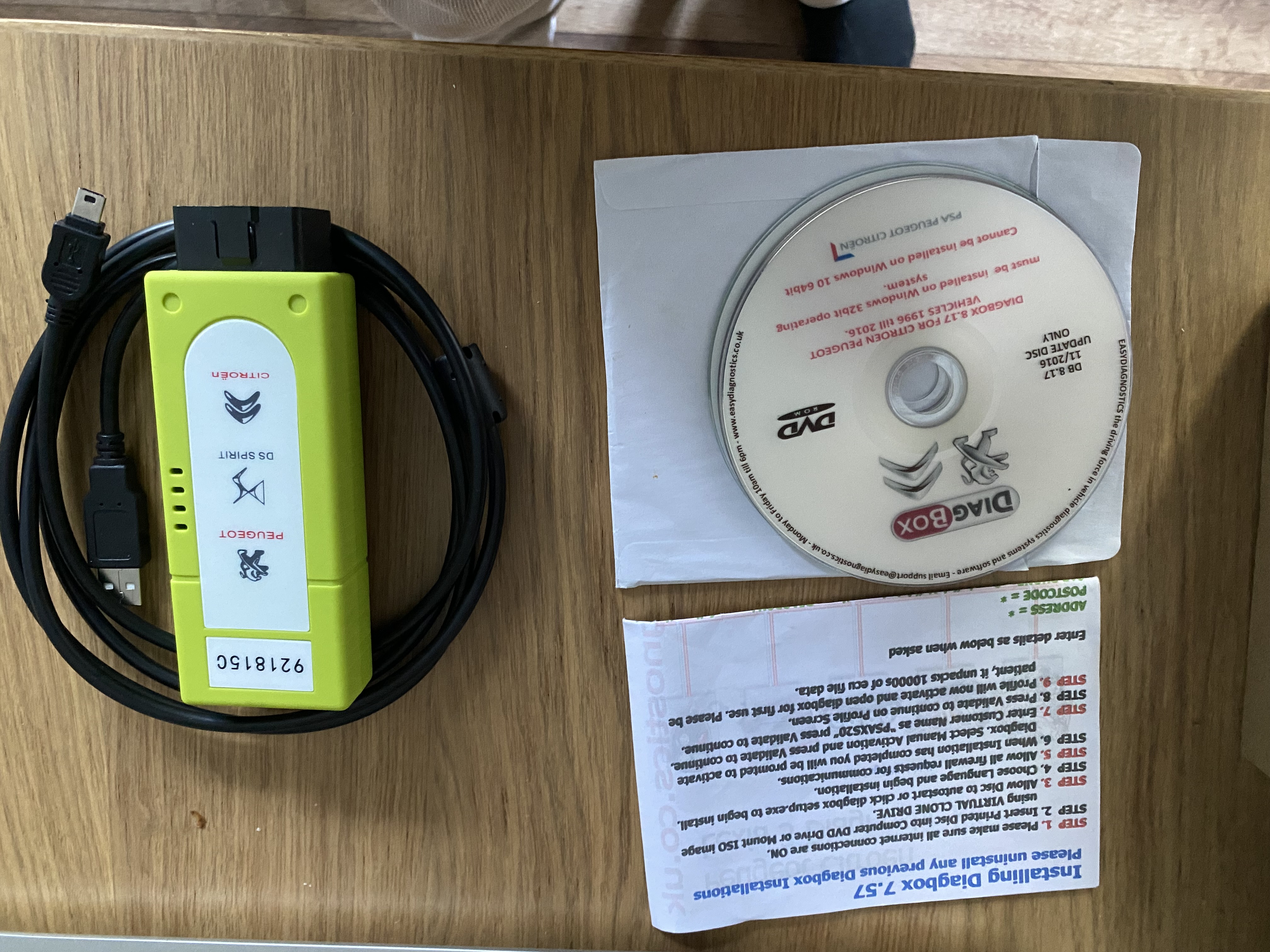

Hi all, I am wanting to have a go at adjusting ride height due to headlamp aim problems. I have been gifted a Lexia Diagbox by the bloke who sold me the vehicle and have only some vague instructions about using it. The CD-ROM is labelled with the warning that the software will not run on Windows 10. I have a fairly modern laptop which runs Windows 11 but no DVD or CD drive which I am told will not be suitable. I am looking at buying a second hand computer on ebay... Trouble is, what to buy? Any ideas? ![]() ![]() |

Mine did not come with a CD-ROM; the seller provided a ready-made VMWare image which is Windows 7 with the software installed. (The Windows is set to French but the DiagBox/Lexia software is set to English.) I could run that on any computer and OS with VMWare installed; I am actually running it on a MacBook. | ||
![]() ![]() ![]() ![]() Member No: #3151
Location: South Queensferry |
VMware is the way to go on newer machines. If you go to the Files section of "Citroën C5 Technical Group" Facebook page you'll find a Diag software download. |
