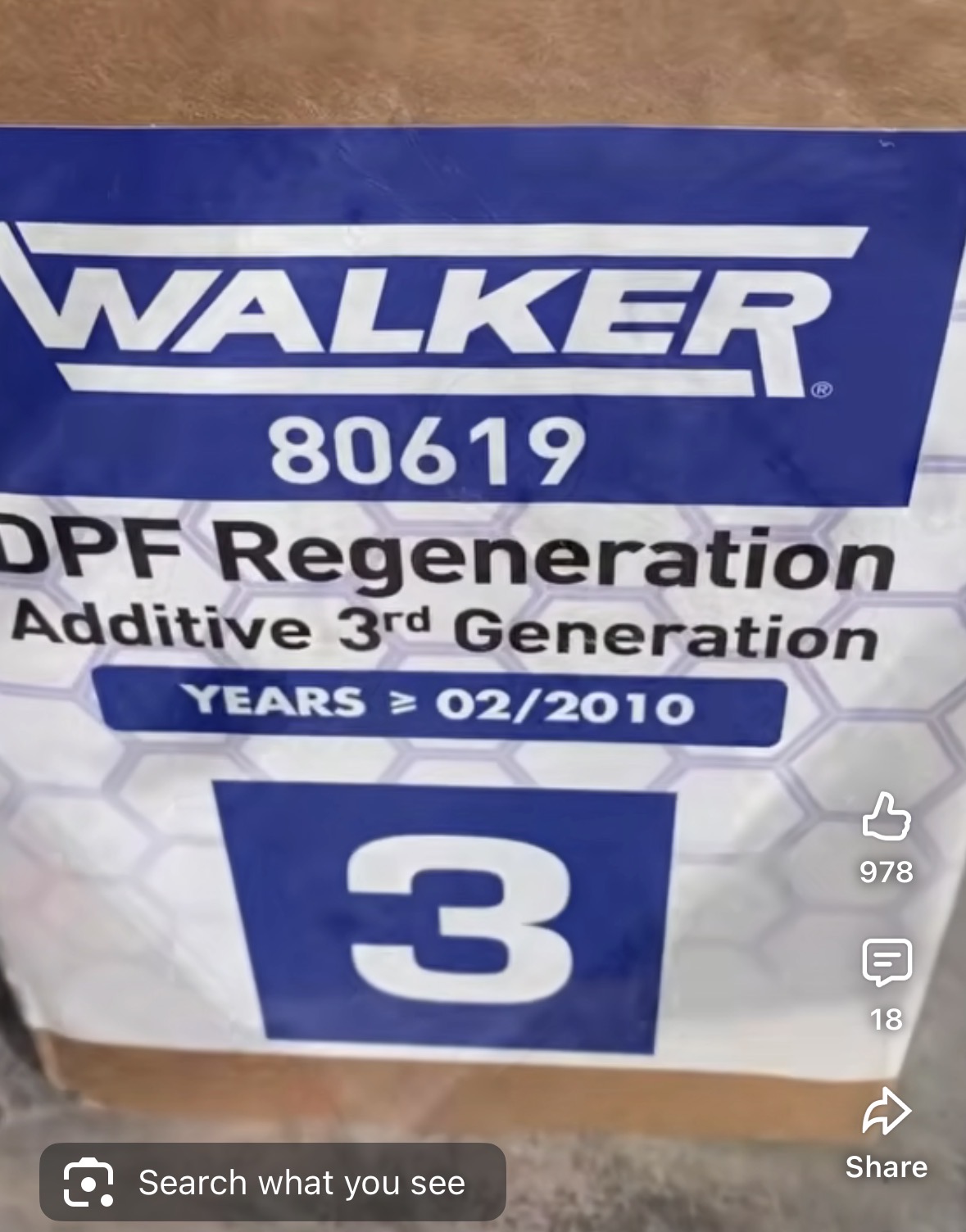

Hello
I received 2 messages all the time in the car screen :
End man faulty & Risk of filter blocking
I think its because Eloys Fluid FAP are missing.
Does anyone have good instructions how to add Eloys Fluid FAP?
How much Fluid I need?
Where to buy the Eloys Fluid FAP, and if there is not Original Fluid that I can add?
for example this in the photo are fit?
Thanks
Sun Jul 12 2026, 08:03am
The additive type varies by the RPO of the car (Build Date) have a look at this FAQ - Click Here -
Once you have worked out which one you need you can do a search but any Citroën Dealer should be able to get it for you

as I understand, the correct Eolys should recognise by the hose color of the car:
Green Clickfit: Eolys 176 (until stocks are exhausted)
Green Clickfit: Infineum F7995
Blue Clickfit: Rhodia Powerflex
How I know which color is mine?
Thanks

Very early cars may have had a refillable 'hard' tank but that all changed to prefilled soft 'pouches' - this download might explain more: - Click Here - but you could use the RPO (build date) calculator, details: - Click Here -

Hi Thank you for the link. the documents are very good.
I found this Eloys Fluid FAP of bosal 258-723 Additive.
How I can know that is Infineum F7995 ?
I saw that the Cross Reference / OE Numbers: 1623961480
