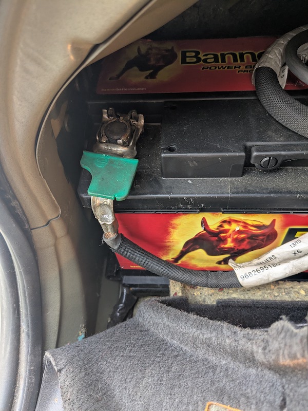

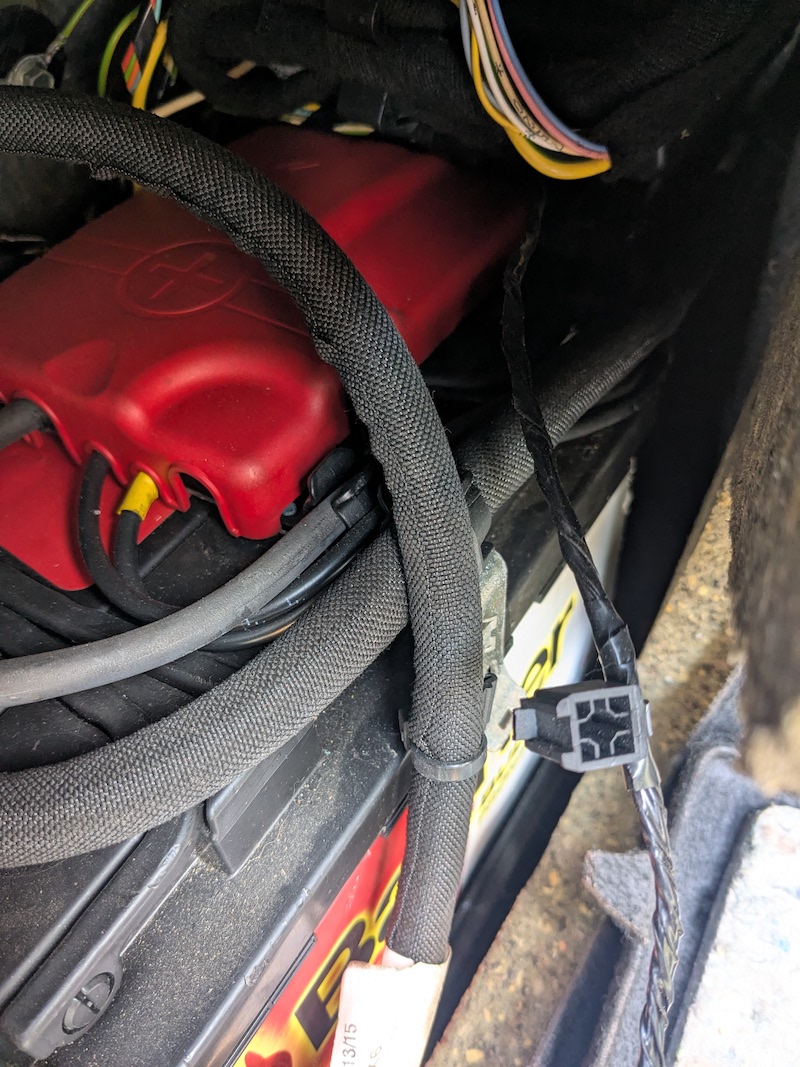

Got the rear seats down, got into the boot, and while squeezed in there, I opened up the battery hatch and had a prod.. which brought the car back to life. This was good news, meaning I could drive home,
However, there's clearly something amiss with that area, as there are cables all over the place, and I think something loose, as if you prod, you can kill the car off again.
Can anyone provide a photo or two of how that area above and around the battery should look, as mine is.... sub-optimal!

If you current cuts out " all the way" that can only happen if one of the battery connections doesn't work, it slightly loose etc.
By the way: I can strongly recommend not to start any modern vehicle with a battery that is flat: Our car's electronics can't cope with that, it might create a bunch of error messages.

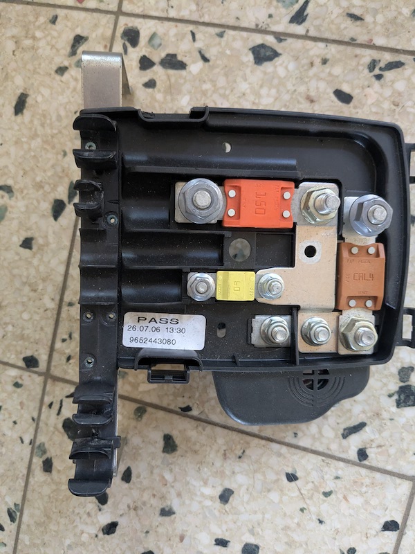

Now on what's on the battery: I added 3 pictures: View on top in the car, the mass connection and a picture of the plate under the red cover with the maxi fuses. ( Mine is a 2007 Petrol, but they are all similar)
The fuse with Cat4 on it is the MAIN Fuse that goed to the front charge points and the starter. A Cat4 needs over 1000 amps for many seconds, that's more a short-circuit connection than a fuse.
I would first check the connection under the mage-fuse plate, then the mass/minus connection .
