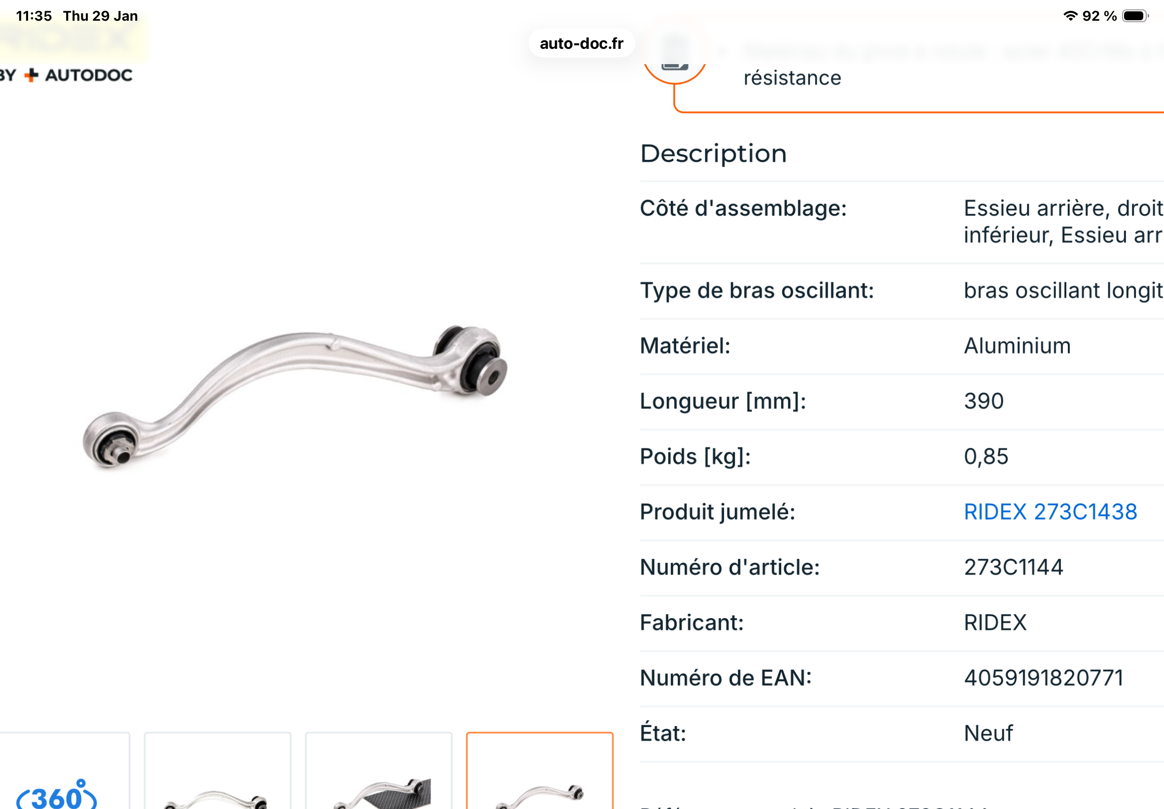

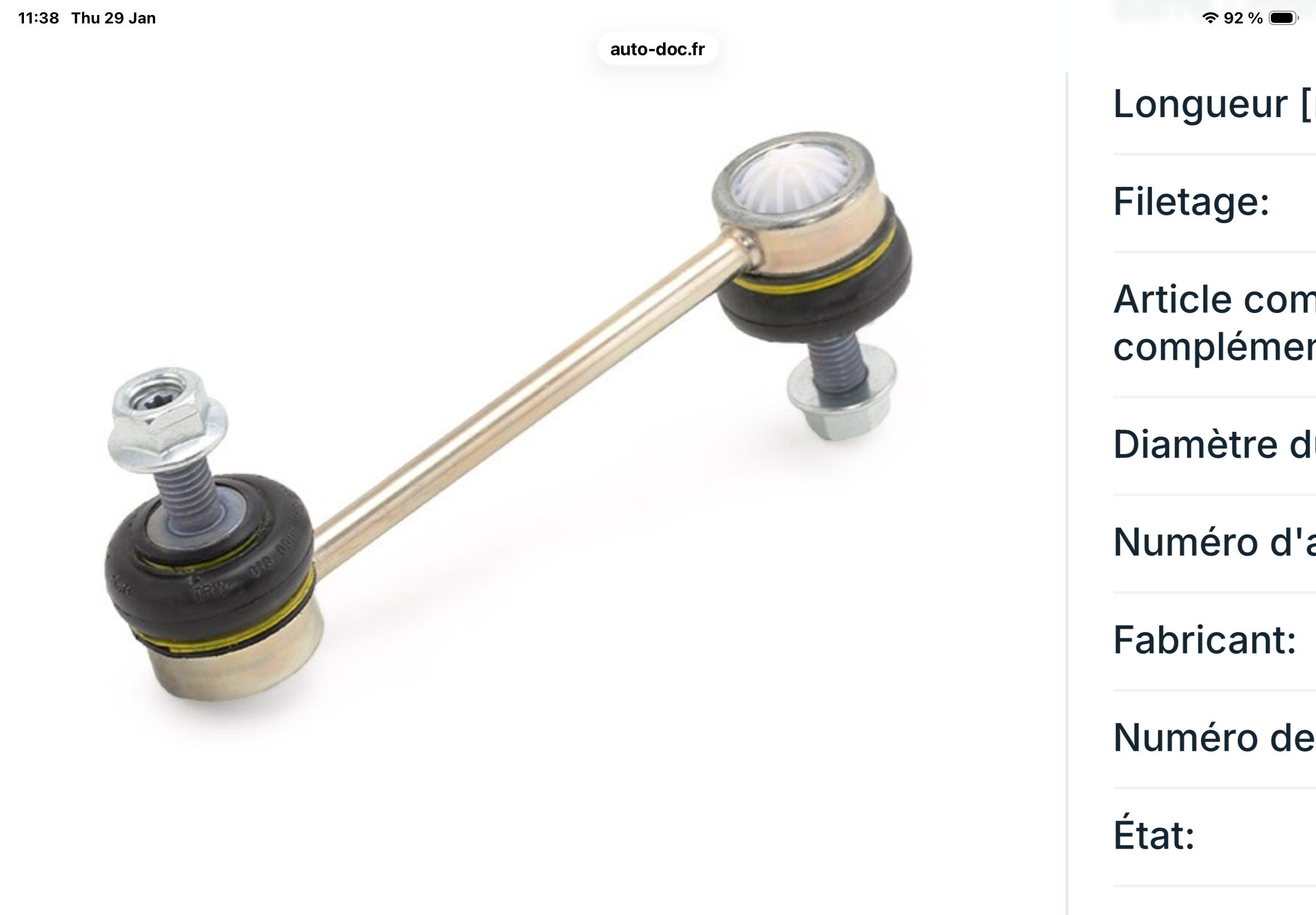

Hi, I have to replace the following parts on the Rear suspension on my 2009 2.2 to pass the French CT (MOT).I know that It should be a « simple « job but I know that these C6s are anything but simple.Does anybody know if the suspension should be left in normal, low or high position to enable removing/refitting parts.I would love to have It in the correct mode before I attempt work.Many Thanks.

I would recommend suspension depressurised with diagnostic or low suspension and battery disconnected.
