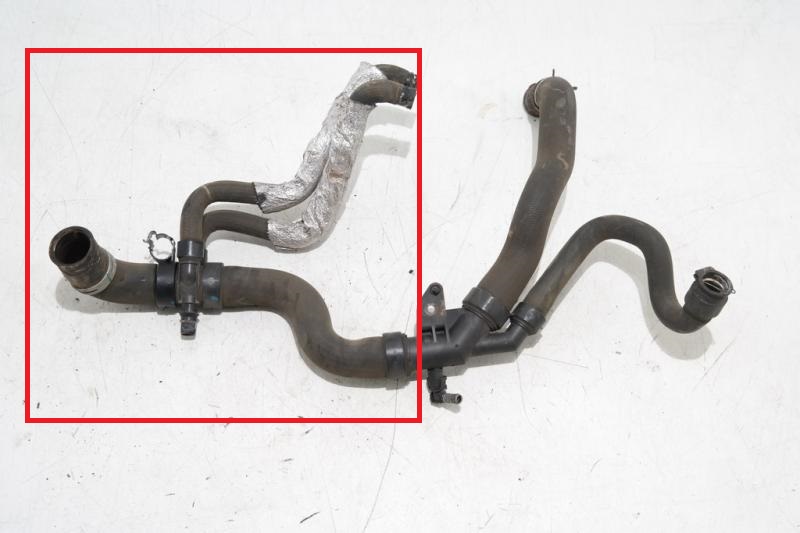

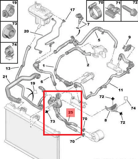

I'd have a question regarding the hose 1343 LR
What is sketched in the overall "3.0HDi coolant Hose Parts" pdf file (see item n.25).....
is only....let's say...one half of the actual part that can be found under the bonnet (see picture below)....
Does anybody know if there're any updated scheme of the complete cooling cyrcuit somewhere?

The diagram is the official Citroen 3.0 HDi Cooling Circuit parts list and 1343 LR is the 'radiator outlet hose' 1343 LQ is the radiator inlet hose. Bear in mind that the diagrams don't always reflect the actual shape, dimensions etc. of the actual hoses, there only meant as an indication of the circuit.
