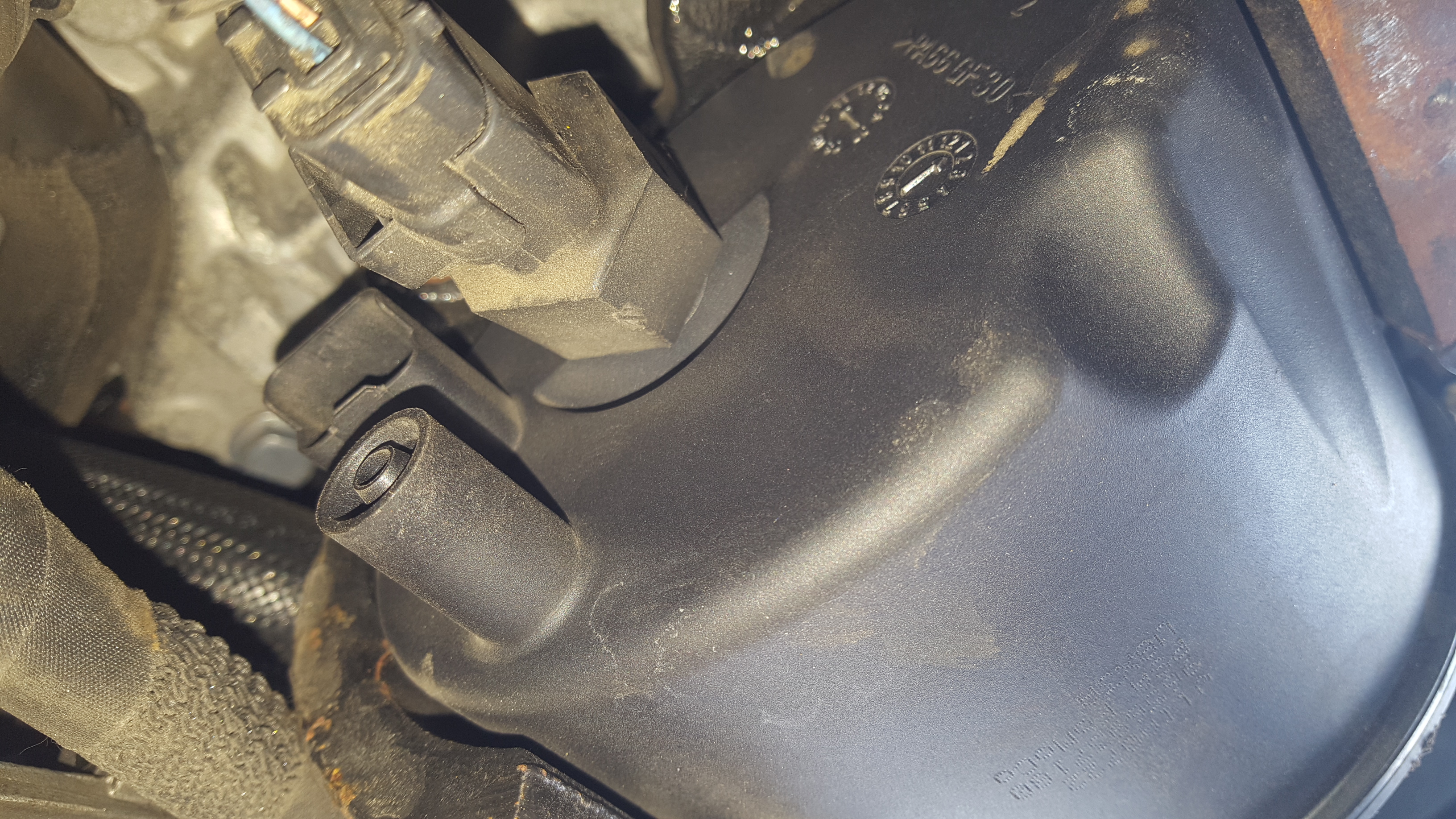

Hi, I've ordered one because it has never been changed, but I would have liked to check for water to see whether my problems come from there.
The thick crash protection is pretty easy to remove, but I couldn't determine how this works nor find documentation for this particular filter (Purflux FCS604).
There's an oblique connector at the bottom which looks like a pressure sensor and a dummy connector. Can't see a knob to turn to bleed water out.
Sat Oct 04 2025, 05:29pm
That sensor is the water in fuel sensor. I don't think you have that kind of problem. If you did have water in there you would get a P2265 error reported by the ECU.

kgw
Sat Oct 04 2025, 06:54pm
Joined: Nov 15 2023
Member No: #5399
Location: Versailles

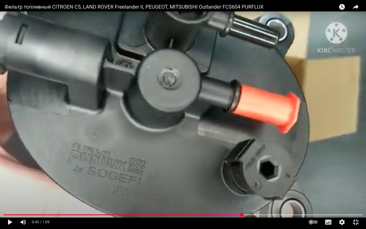

Maybe it's that knob with a hex socket on top as it matches the "spigot" on the bottom. If so, no idea how to use it.

Mon Oct 20 2025, 12:54pm
Joined: Nov 15 2023
Member No: #5399
That knob with 5mm hex on top is the purge screw. It goes through to the bottom of the filter.
There was no water.
The C6 2.2hdi filter is equipped with water sensor at the bottom and fuel temperature sensor on top.
It has an integrated temperature-controlled diverter valve which controls fuel recirculation in order to warm it up. When fuel is warm, it is returned to the tank via a fuel cooler under the car.
