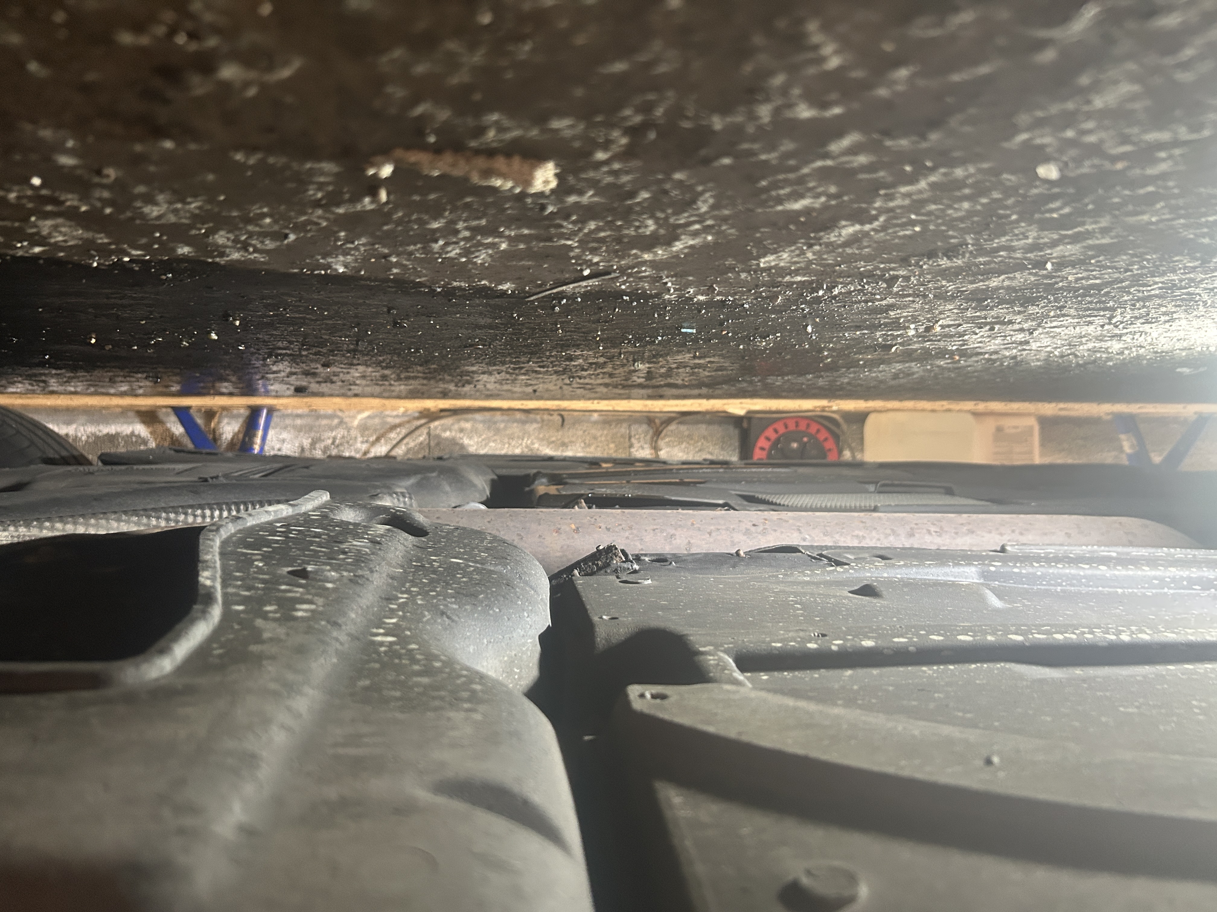

Hi. My ‘08 2,7 exclusive suddenly startet to leak lds fluid. It seems to come from the middle of the underside of the car. The rear suspension has collapsed, but the front is still in normal position. Anyone who got an idea where the leak comes from/ weak spot? ????

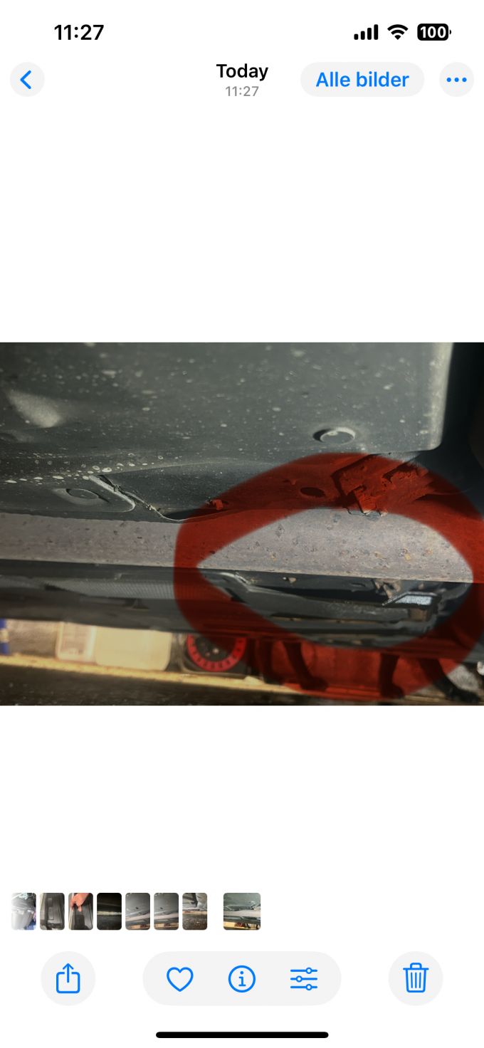

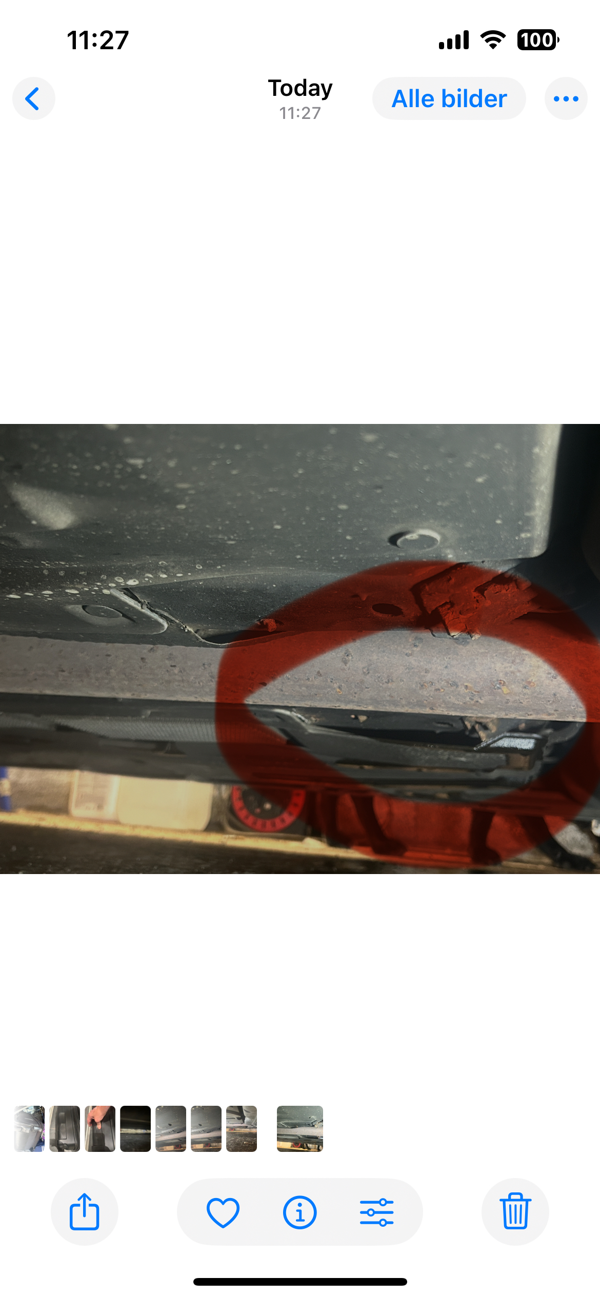

Thanks! It seems to have a leak i the marked area, see photo. Is the hose mentioned located near the rear centre spheres? If so, this leak seems to be located under the middle of the car. Steel pipe?
Fri Jul 11 2025, 12:55pm
Ah, that's too far forward for the 5270VP.
That looks like the steel pipe that runs up and over the tank has rusted out. The simplest repair is to use cunifer brake pipe and join a section on to the steel pipe.
Flaring the steel pipe needs a bit of force, but the flare doesn't need to be very big.
