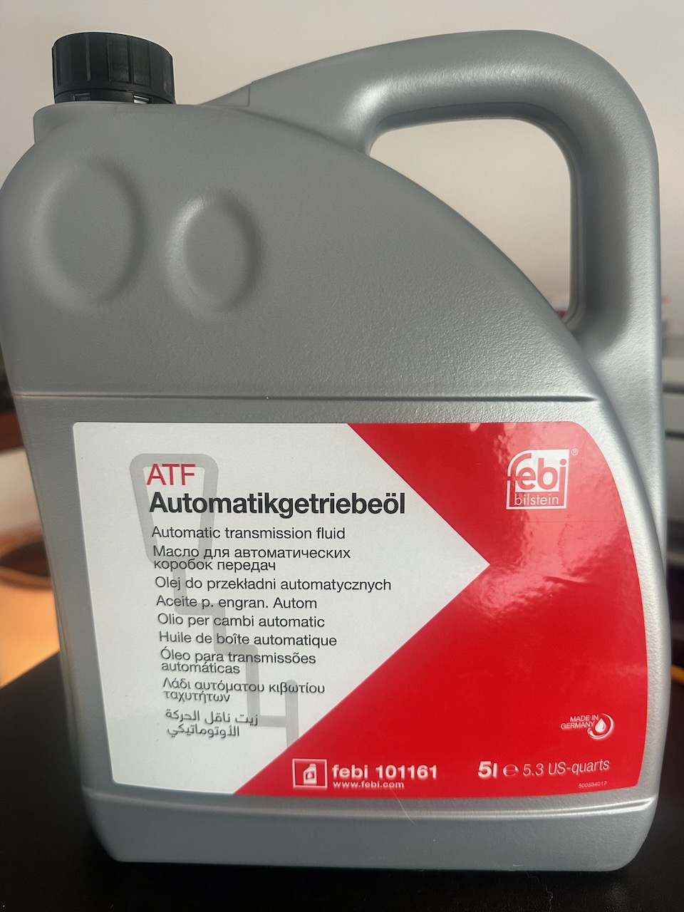

Hello Friends,
I want to change the transmission oil,
what is Transmission oil specification I need?
there is also Filter?
I received from my friend oil that he think it fit, does its ok?
Thanks
Guy

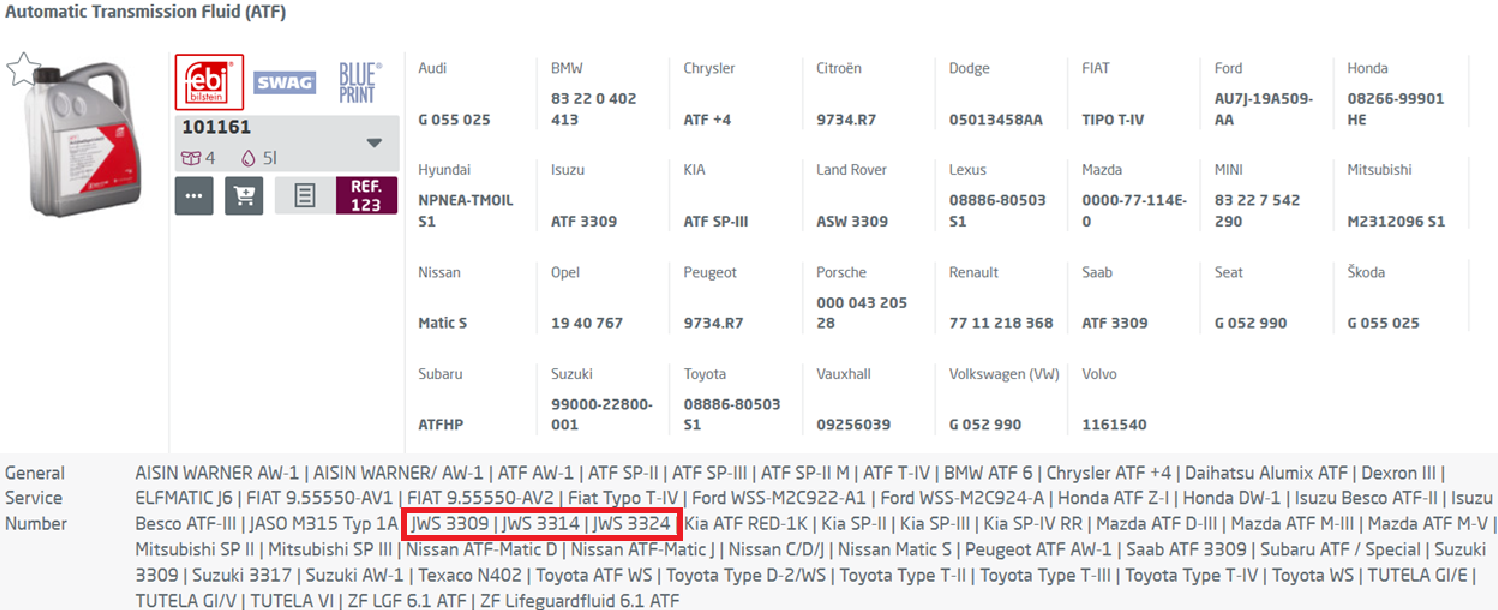

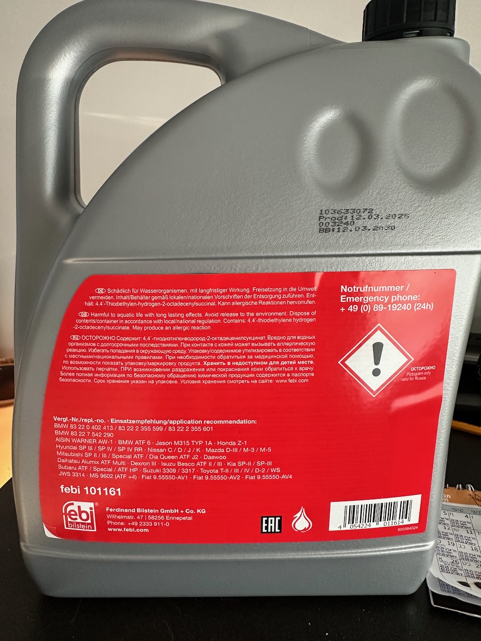

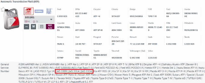

Mon Jul 14 2025, 02:51pm
Joined: Jul 05 2025
Member No: #5897
Location: Tel Aviv
Hello Phil,
I asked FEBI about the oil that I bought and they confirmed that this oil the JWS 3324 is compatible with the febi 101161 product that purchase .
https://partsfinder.bilsteingroup.com/en/article/febi/101161
so its mean that the oil that I bought has Spec JWS 3414 and JWS 3324
