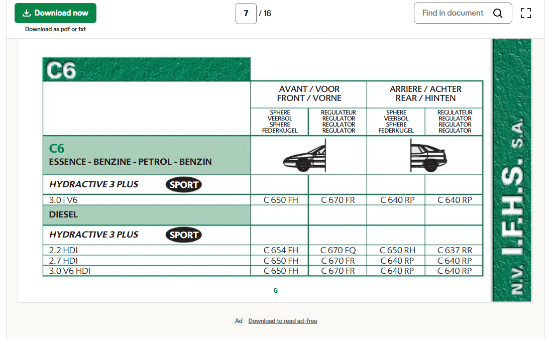

Have a look at the attached extract of the IFHS catalogue.
Can anyone explain what the letter notation means at the end of each part number? Eg. the front corner spheres are part# C650 RH.
Breaking the part number down:-
C6 - the model of car
50 - 50 bar pressure
R- rear?
H - ??
Similarly, for C670 FQ, C654 FH and C637 RR, what does the final letter R and Q stand for?

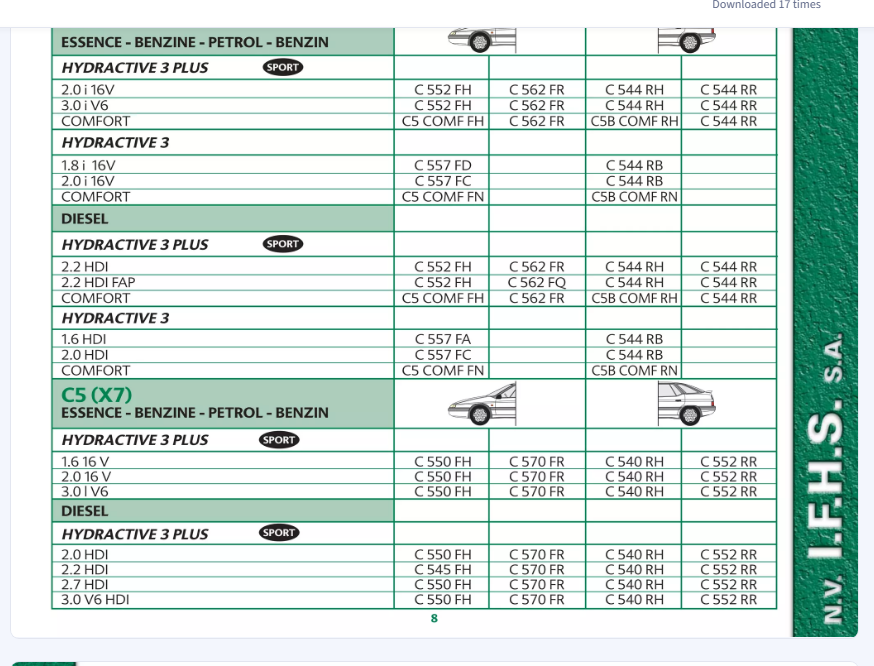

A separate issue. I'm told that the rear IFHS corner spheres for my 2.2Hdi are no longer available and that Citroen are now specifying - due to inventory consolidation or something - rear corner spheres from a C5X7. (C5X7 catalogue extract also attached.)
I know the 2.2 Hdi C6 has a similar suspension to the C5X7 but it would seem that the C5 rear spheres are at 40 bar for the C5 instead of the original 50 bar spec my C6 left the factory with.

My intended supplier informs me that the IFHS front spheres for the 2.2 Hdi C6 are available, although I'm going to quiz him more about that because the part number C654 FH seems a bit unicorn-like when poring over the IFHS catalogue. Similar for the C637 RR rear centre spheres and single front centre sphere, C670FQ.

IFHS part numbers. I believe the F or R is Front or Rear. I believe the last letter relates to the damper valve specification & the details don’t appear to be public.
I would notice the difference between rear spheres at 40b rather than 50b, assuming the same damper valve; not everyone would though! But C5 may behave differently compared to C6 due to weight of car over the rear end, different damper valves & other factors like how the ECU controls the regulator spheres.
I reckon at 5b below original specification, a deterioration in ride comfort is noticeable, even if the ride is still acceptable.
