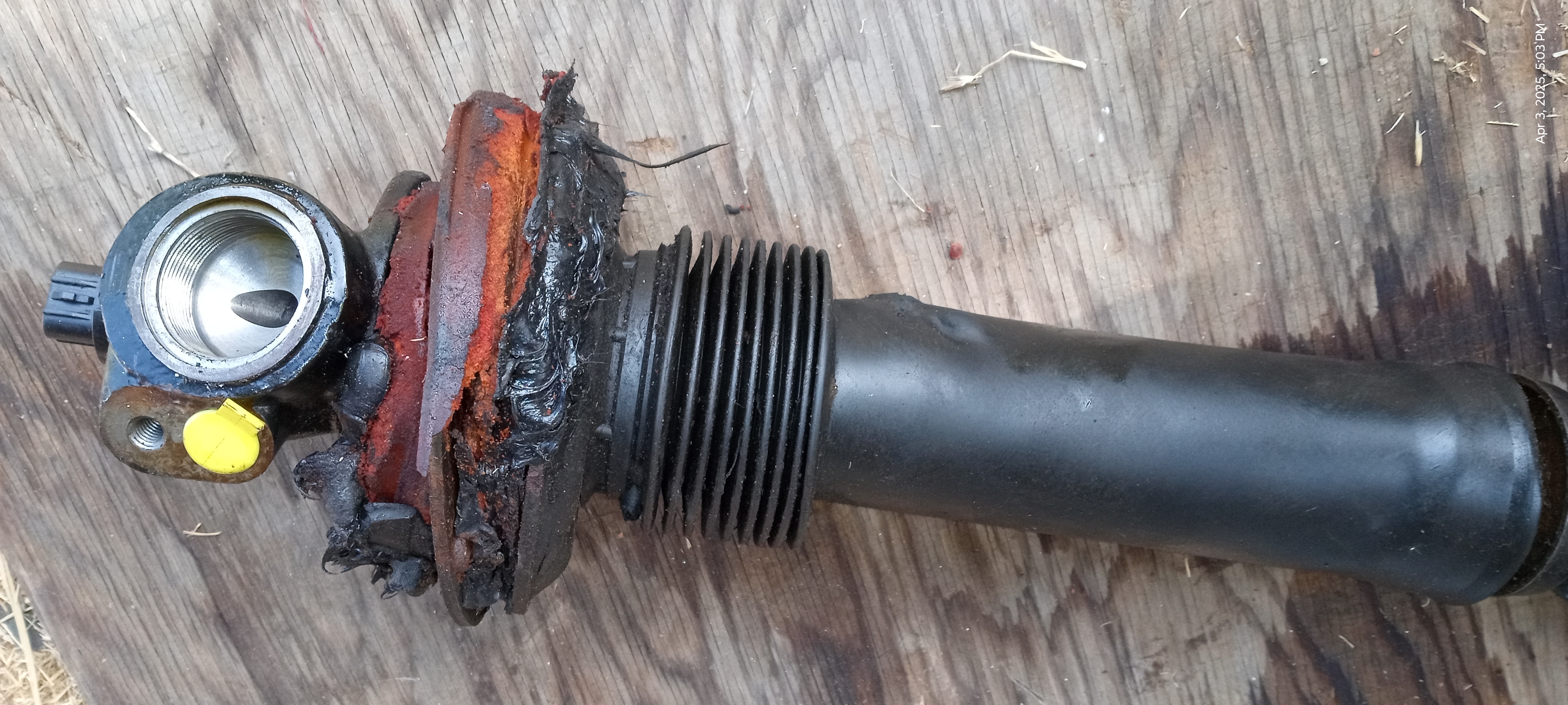

Why has my front suspension foam cushion deteriorated and disappeared ?
Fri Apr 04 2025, 07:25am
citroenroen1 wrote ...
Basically due to age. All foam / plastics degenerate over time, and you are in a hot environment and no, I'm afraid that you are unlikely to find a replacement for it.

How do they become bad? Do they make noises? Does a shock absorber become bad when it starts leaking fluid? Does a bad sphere make sounds?

Not shock absorber, it is a suspension cylinder. Old Citroen technology (DS-->XM) was made in-house and lasted "forever", probably because of LHM oil circulating with return pipes. New system (C5-6) cylinders are not lubricated with oil return system. Sourced from Japan (?) and made with "shock absorber" technology with limited lifespan.
Usually the first problem is leakage of LDS (I am on my 3d set cylinders). Foam support problems also reported, like your problem. Designed to be changed as a unit and still delivered from PSA/Citroen. The real shock absorber is not a source of wear and problems, it is an electronically guided block of valves.
(These are my "theories" based on experience as Citroeninst for 45 years, have I understood it right ?)

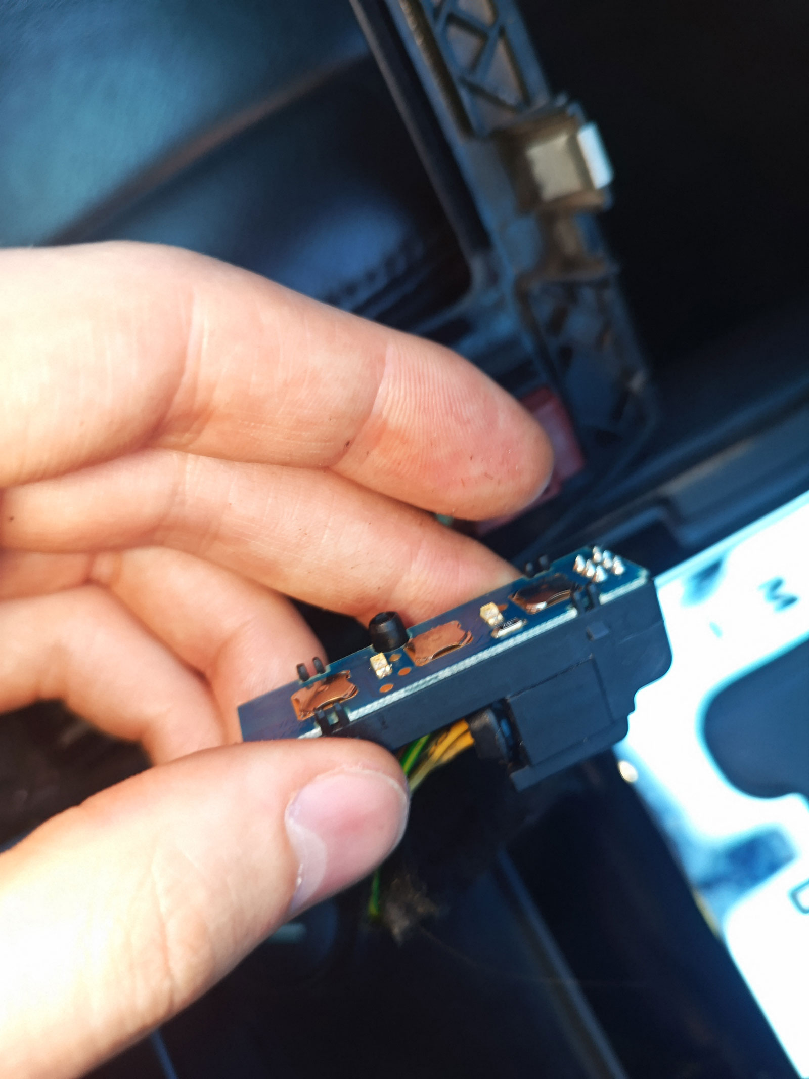

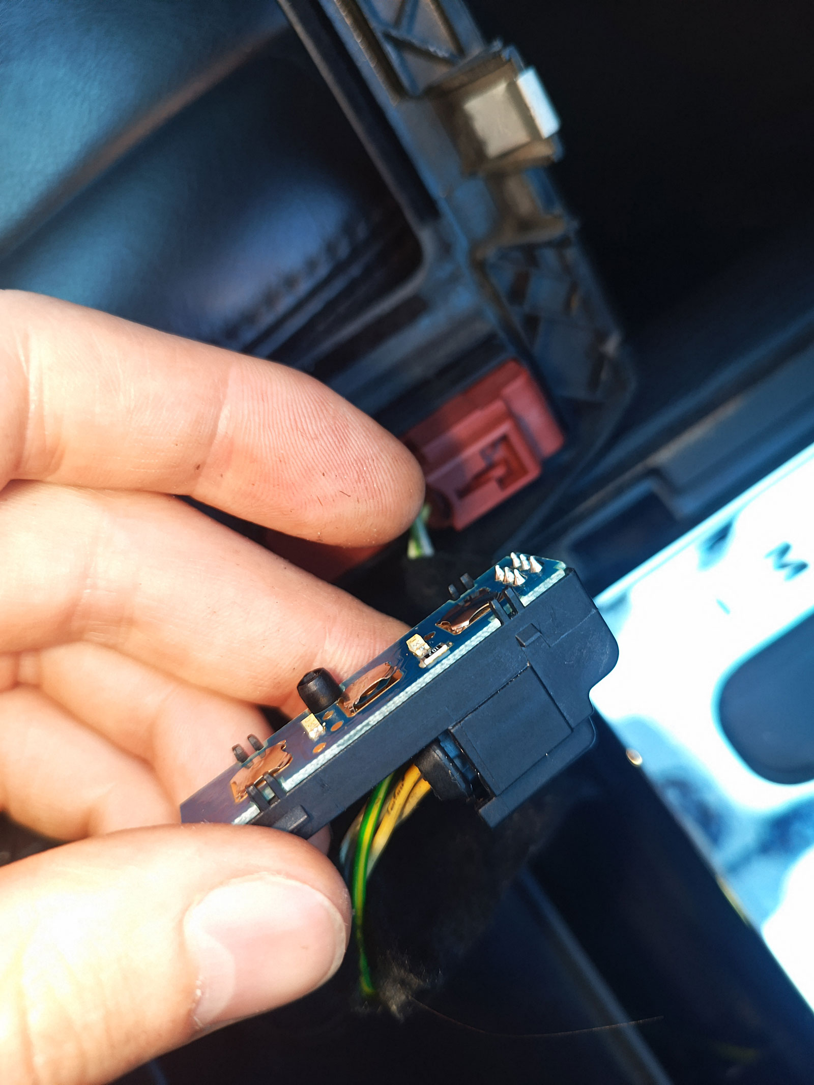

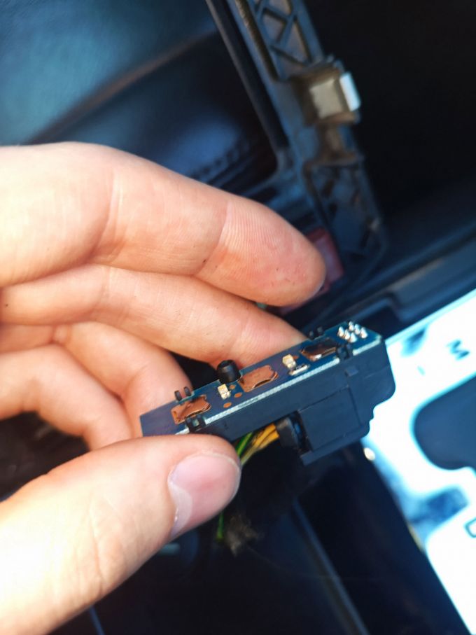

I will try it later cause now I'm angry. I got my car back with suspension sport mode on. The problem is I can't turn it off. I tried to disconnect a battery that didn't help. I tried to check faults, nothing related to suspension softness.
I didn't find an actuator test in diagbox that could rule out a bad button. Up and down buttons work, car goes up and down. Any idea of this one? I will look for a manual, maybe it's just oxidation.
Update: An issue is fixed by restoring a plate of button in it's location. I have no idea how it happened.
Good Gap:
Bad Gap:
