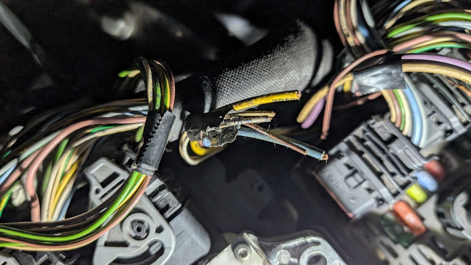

Hi Friends
Ive got a problem. I found near bsm 5 broken wires. Idk where it was. Maybe someone can help me. Ive got rear amvar suspension fault and sterring assist fault.

Hello TomekWGM,
Can you identify which plug they have broken from?

thats the question - idk where are they from. someone says that it spare wires from BSM to cabin.
Thu Feb 13 2025, 10:50pm
There are a number of wires in the under bonnet electronics box that are not used. They're normally routed under the BSM and just hide out there. I can't say what colours they are but I can check if required?

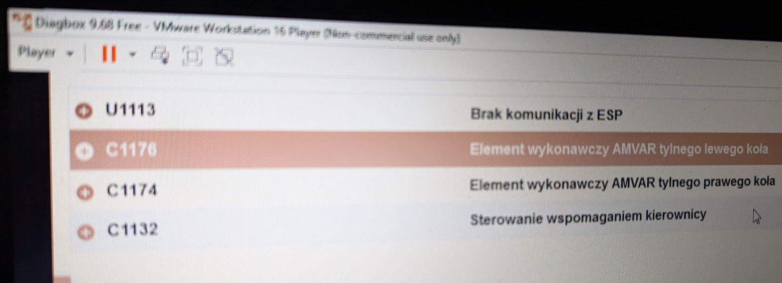

of course. Here you are:
ESP is not imo connected with this. Ive got rear left sensor fault - Im going to change it tomorrow - but....its snowing.

Is your car a 2.2 by any chance?
The C1132 relates to the power steering and if it's a solid fault, it will need investigating.
The C1174 & C1176 would suggest you have two faulty rear shock absorbers, a faulty AMVAR ECU or a wiring fault. Checking the wiring is probably the least expensive option to start with.
The U1113 will probably be because of the suspension faults and will likely clear when the others are fixed.
