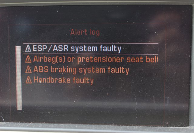

Out of the blue car fault log came up with ESP/ASR faulty
air bag seat belt faulty
ABS braking system faulty
Hand brake faulty.

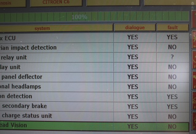

Time for Lexia a quick check and needless to say a load of fault codes cancelled them and re read the dialogue and most faults still the same as before.
This could be enough to call it a day with the cost of what was showing.

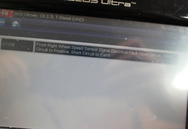

Time to see what Snap-on shows just one major fault (c1330) Front right wheel speed sensor signal electrical fault open circuit to positive, short circuit to earth.

Lexia faults + more showing.
I then had auto box ECU faulty, electric hand brake fault.

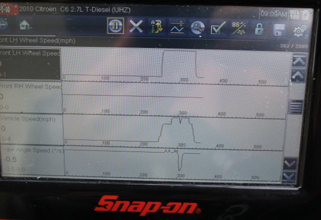

Enough of this, time to do another Snap-on live data with a short drive.
Confirmed just one fault showing Ft RH speed sensor.
Replaced with a spare and a road test and all is well.

For a C6 you should forget the lexia app and only use Diagbox.
Most of the errors will be communication errors triggered by the ABS module having a fault with one sensor. It effectively tells all the other ECU's not to rely on me for info and the other ECU's say "Oh I can't work properly without you. I better tell the driver I'm not playing"
