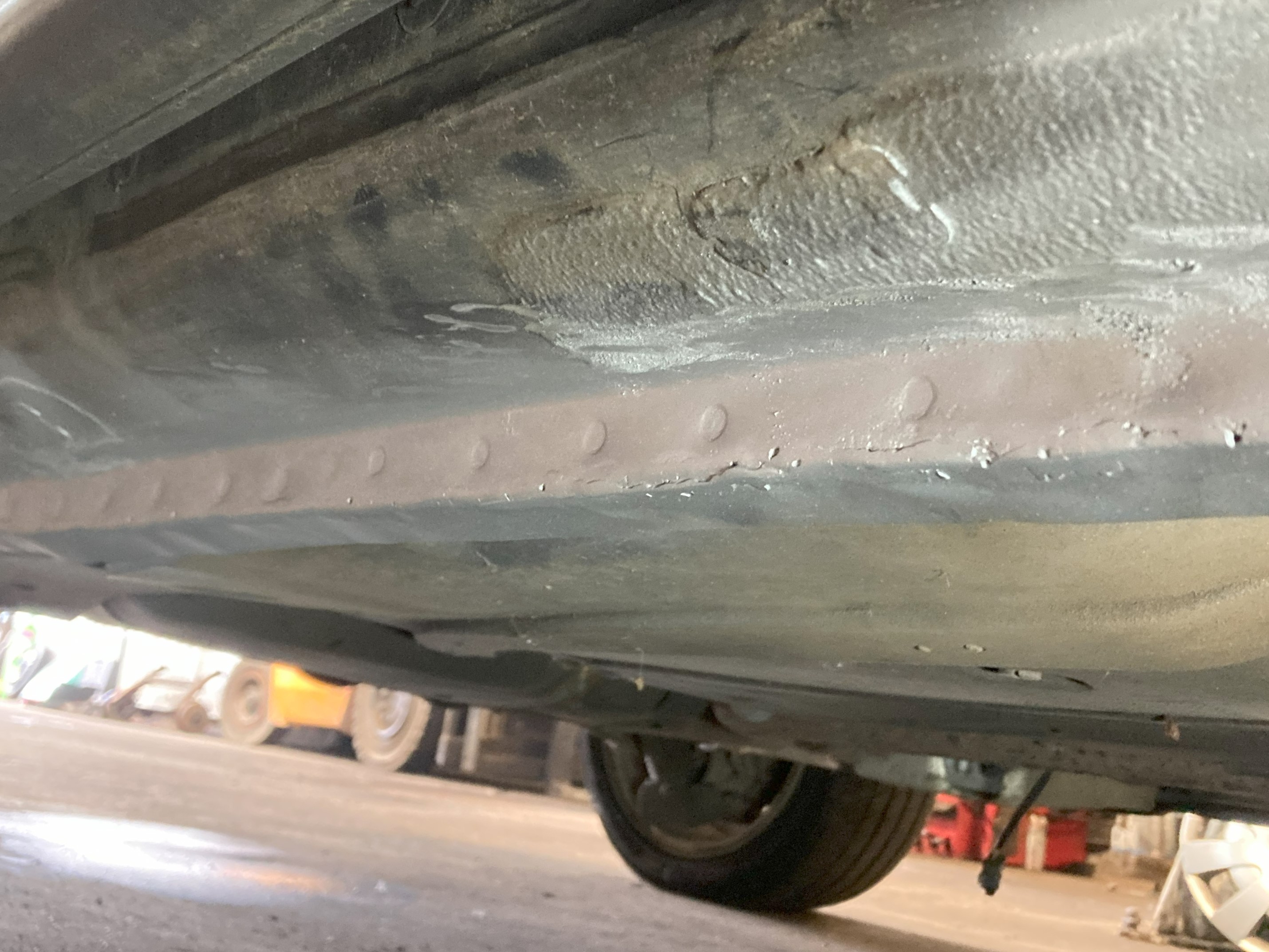

I've yet to properly get under my C6, but while checking some undertray parts and the inevitable crushed jacking points, I found the lip of the sill where the plastic trim is screwed in is rusty. I don't mean 'brown crud', I mean 'chunks breaking off when I get the dirt and mud out of the curved channel there.
Because it's within the sort of window where factory sills may still be available (if not cheap) and also while it's just a thin edge holding trim, rather than structural yet, I might get this fixed. Or I might clean the area, rust-treat and cover it in black waxoyl.
But has anyone encountered this before? Any tips on sorting it? Is it common for a C6's sills to rust? I though PSA had sorted their rustproofing and body quality, but I guess the abused jacking points and possibly a life near seaside/salted road areas has done the inevitable.

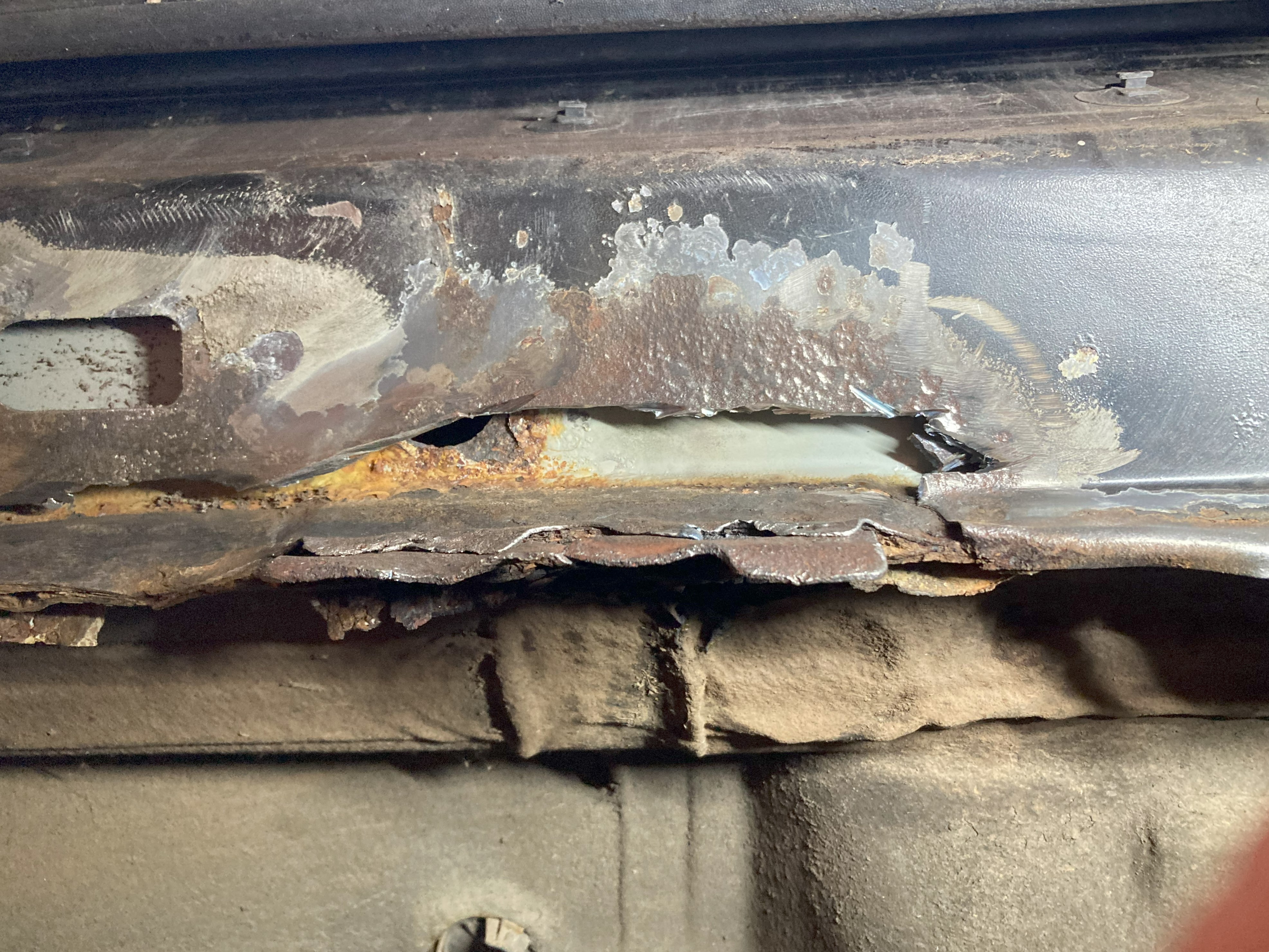

Thankfully the only real issue (so far) is the area you mention. Although I suspect inner sills either side of the tank will be a problem area going forward.
Being in salty Scotland, I've repaired a few cars now. The design of the sill with a single thickness lip is always going to be the first to go. It's not too hard to repair with a simple 25mm wide strip of steel welded at the bottom corner of the sill. the biggest problem is getting the sill covers off without breaking the NLA clips!

Wow, that's got well settled in! Definitely worth me taking the covers off and cleaning the area properly, I think - I don't know anyone who welds down here and it's a skill I've yet to attempt (I don't even know if I can or can't but I'm so bad at soldering or plastering I suspect welding is the same issue).
If my jacking points aren't too rusty I'll look into the induction heating - suspect that might be how to fix the crushed forward footwell box section as well. I'd have been raging if it was done to my new C6, at least with this one I have to tell myself to just enjoy the leather and 'waft' for pennies essentially.
