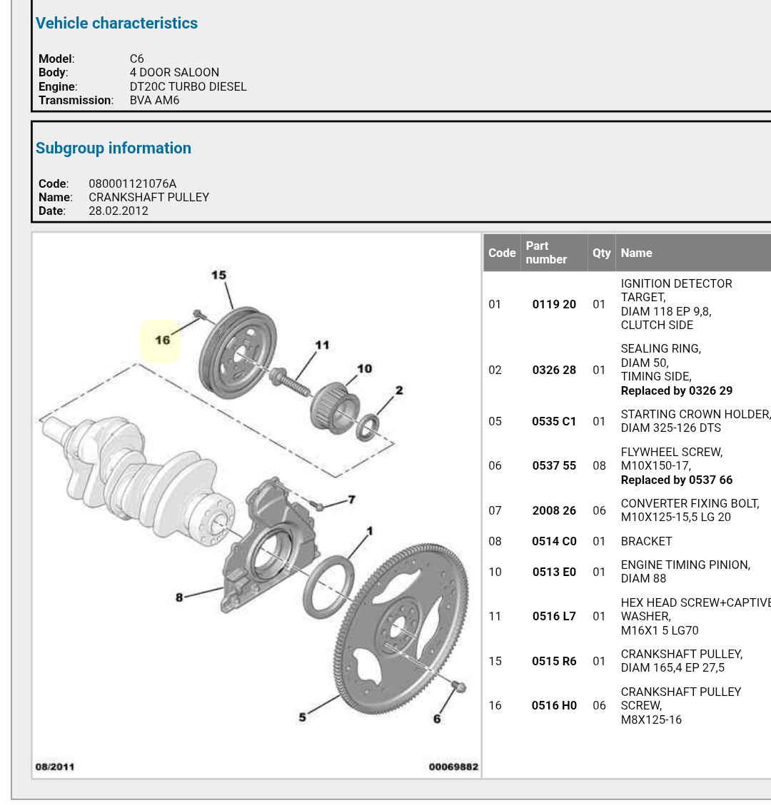

Hello onthecut,
On the 2.7 or 3.0HDi you don't have to take the crank pulley off the crankshaft. The belt pulley comes off separately with the ring of small torx headed bolts. It makes that part of the job so much easier.

Tue Nov 25 2025, 11:29pm
cruiserphil wrote ...
Hello onthecut,
Does anyone remember which E socket fits on these bolts? It's E12
