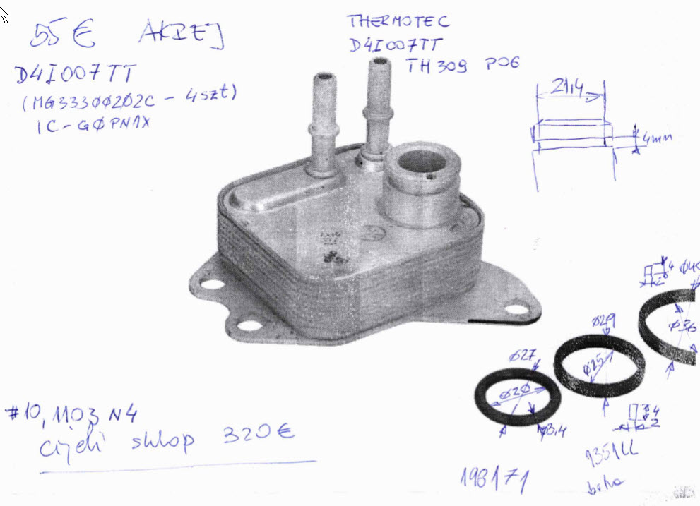

Since there were no additional suggestions in this thread, I have ordered the whole engine oil-water distirib chamb, part number #10, code 1103 N4. The original part was not available, so I have ordered aftermarket one that comes with bracket gasket 1104 41, part number # 11 on engine oil sump filter probe assembly.
Krtcho
Fri Jul 04 2025, 12:10pm
Joined: May 07 2016
Member No: #2620
Location: Fazana
By the way, the O-ring dimensions for part #12, code 1981 71 are:
inner diameter: Ø20 mm
outer diameter: Ø27 mm
thickness:Ø3,4 mm

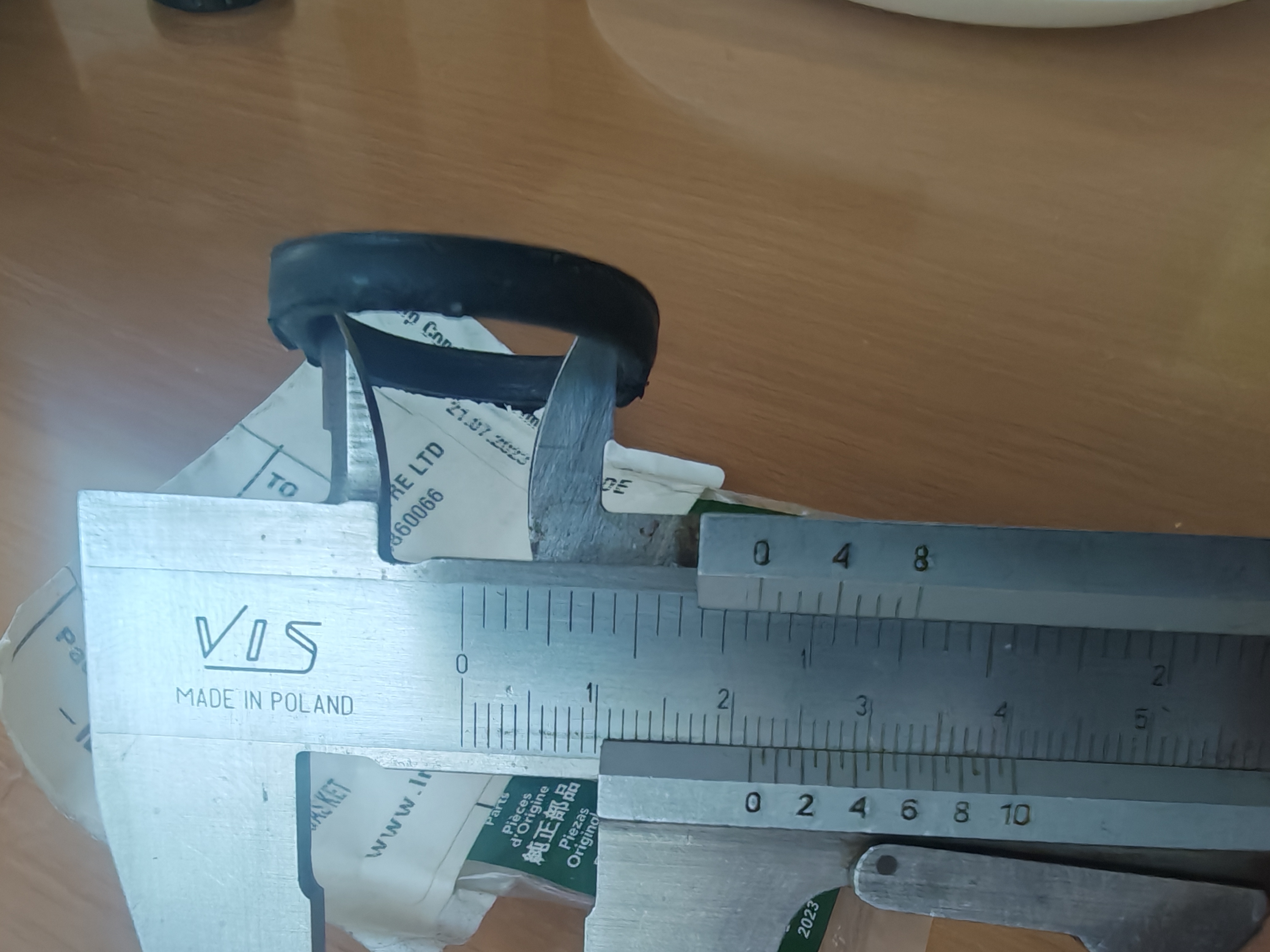

This is the old o-ring 198171 taken from my C6, the slide rule shows for inner diameter something around 21,4 mm (can't be 100% sure because the o-ring is twisted and worn) and the cross section is squared.

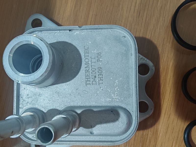

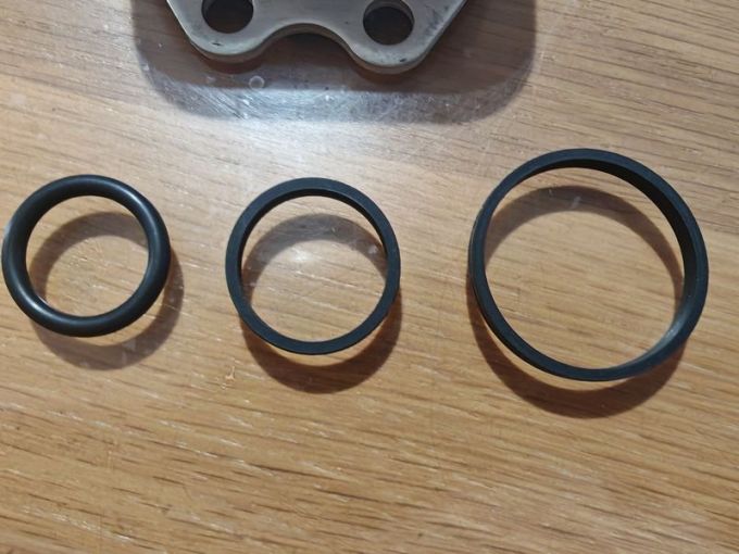

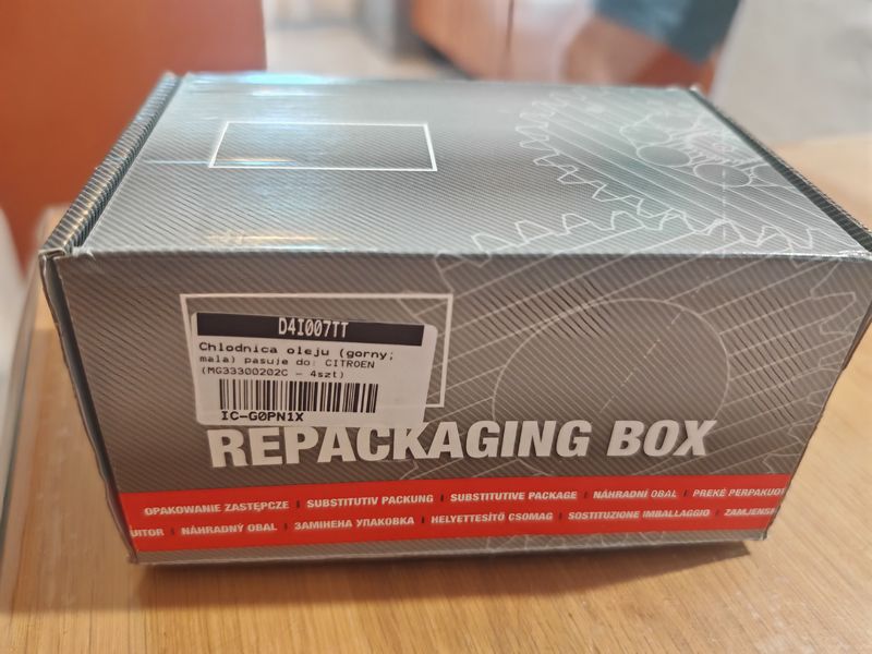

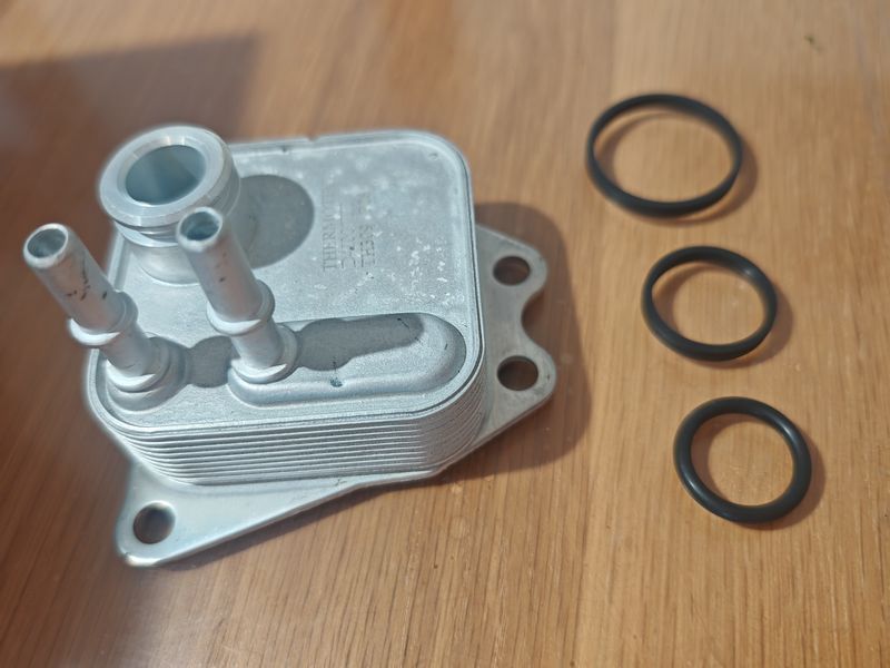

Than at the local automotive shop that sells aftermarket parts, I saw that there is upper coolant part that is not separately listed, shown at the attached picture. There are three o-rings within the box, so I've measured o-ring code 1981 71, and also the other two. I'm not sure where those two additional rings go, suppose beneath the radiator, but not sure. Look at the attached photos. I have also printout of that part that is obviously produced in Poland, the part number can be seen on the box in PDF file.
