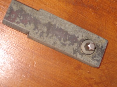

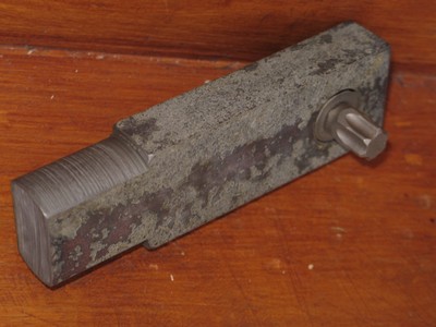

Pete or anyone else, when it comes the time to replace the disks, the Torx fasteners that secure the caliper bracket to the hub need removing. This applies to back and front disks.
The Torx fasteners are extremely tight, as they are Loctite'd in place (if such a word exists).
Using a Torx key in a socket put the lever arm of the wrench some considerable distance away from the fastener: this carries a risk of cranking over the torx key and rounding the fasteners instead of removing them.
The attached "flogging spanner" with a 10mm internal hex enables a shortened key to be used and therefore minimal or no standoff from the fastener. A heavy hammer can be used to shock the fastener and a large pipe applied over the end to get controlled leverage (almost pure torsion no bending).
The "flogging spanner" is made from a 1/2" drive 10mm single hex impact socket, press fitted with a heavy interference into a suitable heavy bar.
Regards
G

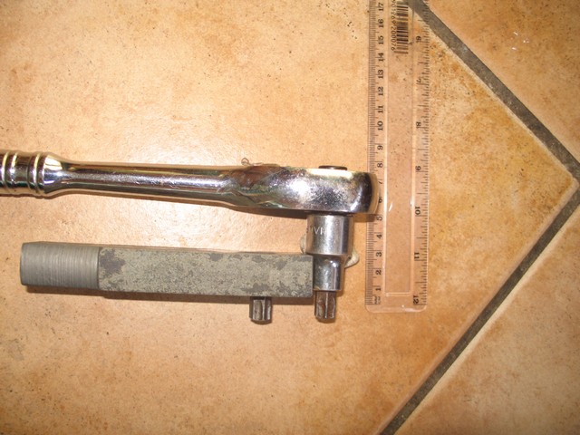

Here's a side by side comparison with a standard socket and wrench.
Regards
