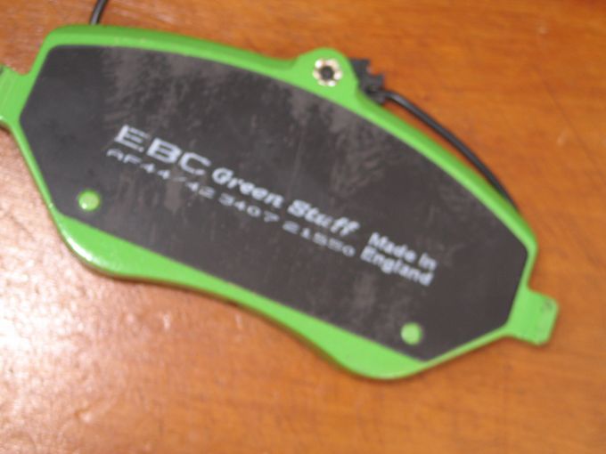

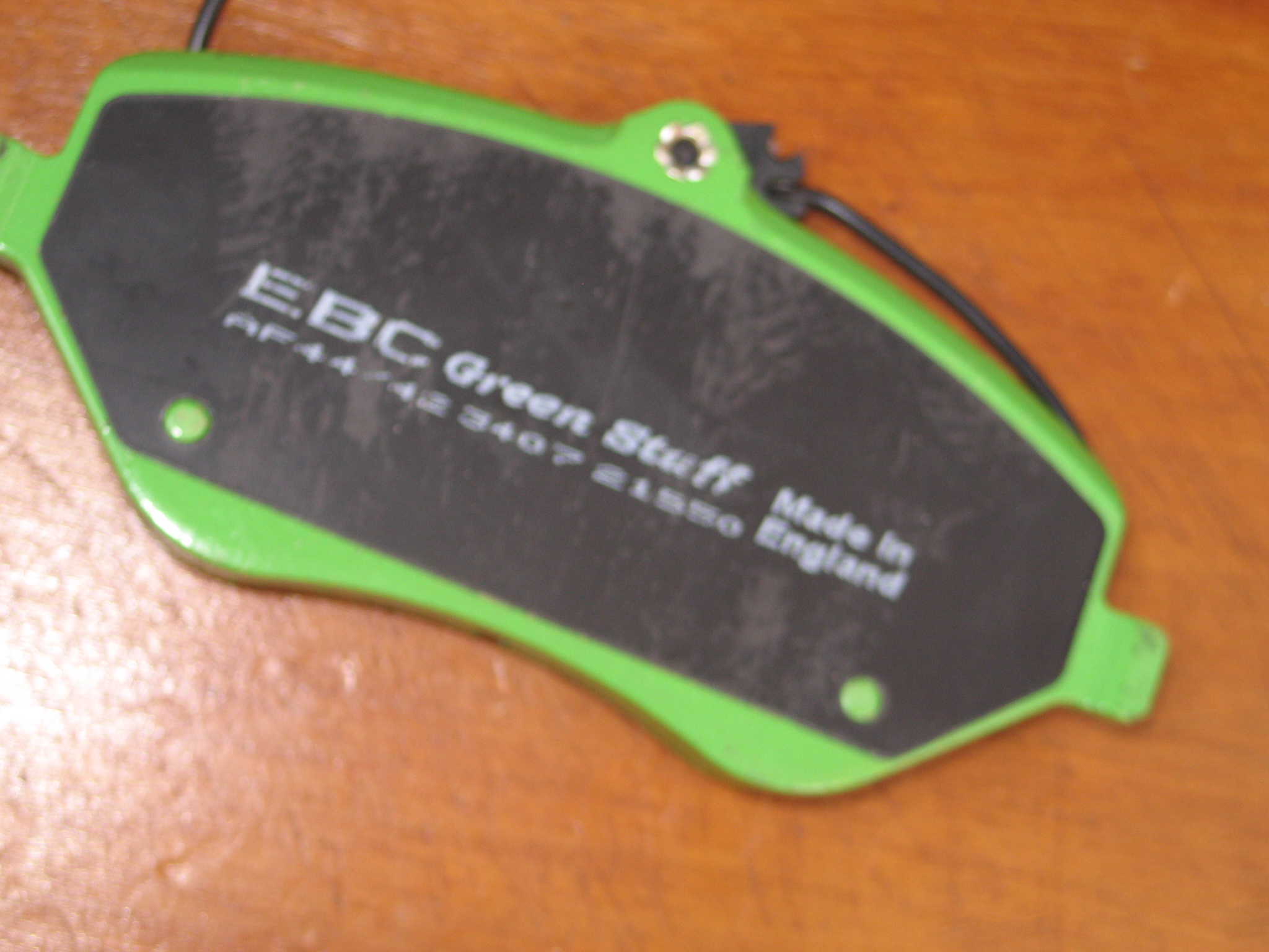

I'll be replacing my front disks and pad soon. Disks are worn to service minimum and pads are about 1/2 to 2/3rds worn, but at much lower mileage suggesting car was mostly used for short trips prior to my ownership. Replacing pad alone for £200 sounds a bit steep. I priced pads at about £40/set and Greenstuff at about £80/set. As part of preparation for the pad change, I've flushed out all the old brake fluid and replaced with Castrol Super Response DOT 4 (see my separate post). If you just replace the pads without changing the fluid first, you risk pushing old fluid and debris into the ABS system.

@gmerry - Be aware that 'Greenstuff' pads don't have the anti squeal coating on the back and nor do most aftermarket ones so you may end up with noisy brakes
Use your C4owners Premier Membership to cost a set of OEM Citroen ones from [Dealer 1] before making a final decision.

Maybe EBC have uprated their specs, but these C6 pads have the antisqueal backing.
I'll still treat these as an experiment in terms of initial bite, dust, wear etc. The OEM pads are of course the safe choice but even these had a bit of squeal.

Interesting, I got Greenstuff pads for the C4 and they had nothing on the back at all and squealed badly at low speeds/pedal pressure.
Maybe they have uprated things
