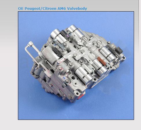

Poor/clunky gear changing due to sticking electrovalves in the gearbox.

The fluid contaimination issue is to do with wear of the alloy housing for the electrovalves. Changing the fluid for this reason will defer the point when major repairs will be required.

This is why you should change the fluid, just to give these valves a chance of working correctly.

Another photo (source is Sussex Auto Transmissions)
